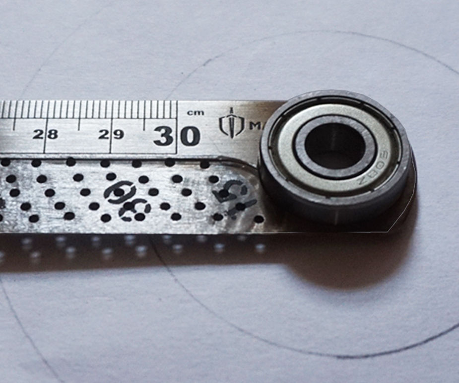

Step 14: Compass
The compass works by hammering a pin through one of the holes...
...each of the holes is in a multiple of 5mm...
...the last 5 holes along the short end are at 1mm intervals...
...giving a range of 1mm to 55mm...
...circles below 5mm are a little difficult to draw in reality.
Place your sharpened pencil in the desired hole and spin around.
