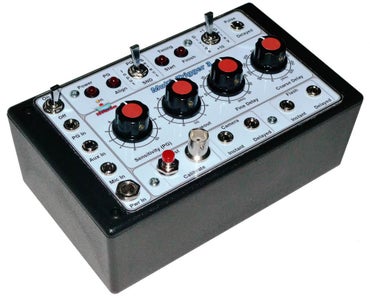

The Multi-Trigger 3 and AstroSplash from HiViz.com are very nicely thought out kits.
Using good quality components and nicely detailed build instructions.
However, the one problem I found, was that after use & packing away, it was very difficult to set up again to the exact previously used settings, wasting much time having to take many test photos.

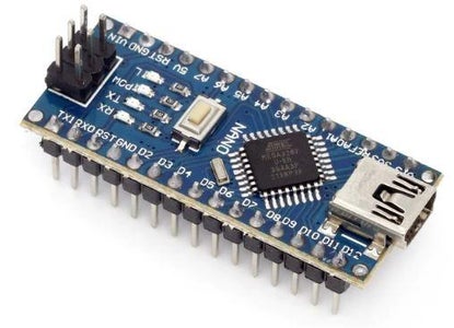

Arduino Nano. This is a cheap microprocessor, pre-mounted on a pcb complete with power supply, USB interface & connection pins.

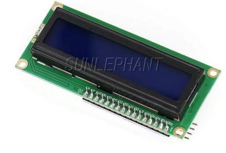

LCD module. LCD, pre-mounted onto a pcb, complete with interface board & connection pins.

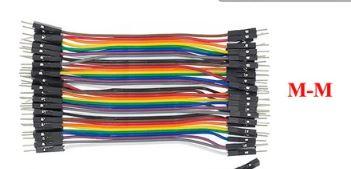

Wires. Dupont wires are pre-made wires, to mate with the pins on the two boards above. This makes assembly very easy.

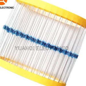

4 resisters. Used as a 'potential Divider' to interface the HiViZ unit to the Digital Display

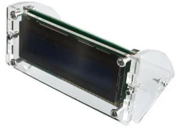

Stand. Optionally, a clear plastic stand can be purchased, to mount the LCD and Nano into, In turn this can be mounted to the Trigger-Timer 2 or AstroSplash, or left free-standing.

The test port output voltage from HiViz is around 8 volts (according to HiViz, I have never actually measured it)
This in theory means it is too high to directly connect to the Arduino input pins.
For this reason, the inputs are shown with two resisters, forming a 'potential divider' which halves the voltage.
