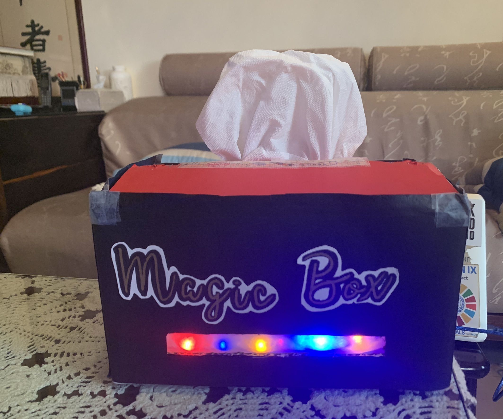

Introduction: Music Player Night Light
This night light will turn on by itself when you turn off your lights when you go to bed which you can then press the attached button to play some music off your laptop!! To make it even more useful I placed a box of tissue in the box to also stabilize my breadboard.

I aligned them in a row and 2 holes from each other to have all 10 LEDs fit on the breadboard. The right side is the longer lead, the positive end, that connects with a digital pin. The left side is the shorter lead, the negative end, uses either a 220 or 100-ohm resistor connecting to the negative rail of the breadboard. The order and arrangement of the colors don't matter, you can place them based on personal preferences.
*Using a 220-ohm resistor gives you a smaller and more concentrated light while using a 100-ohm resistor seems a lot brighter compared to a 220-ohm resistor. So you can randomly change any color of light from a 220-ohm resistor to a 100-ohm resistor to show a sense of variety in your results.

The box has to be able to fit your Arduino thing and doesn't have to have a look pretty because you get to decorate it later on. What I did was cut out a rectangle and stuck a piece of paper to soften the light on the long side of the box. There is a second square hole on the left short side for your USB cable to go through. Then I decorated the box with colored paper. On the right short side is a tiny square for the pushbutton's wires to go through. But make sure it isn't' too big or else the whole thing would be pulled out. The last small whole is on the top of the box where the photoresist can fit and detect the most direct of energy. And because I made part of my box a tissue box, on one side of the top of the box, I also cut out a small rectangle so the tissue can be pulled out. The two pieces on top were fixed with staples because I couldn't find anything better that could make them stay. But if you have a better idea please do so since using staples is really inconvenient.

When you turn off the lights, supposedly the lights should be lighting up one by one. Then when you want to, you may press the pushbutton the play music from your device. Keep in mind that the device has to be on in order to play music.
