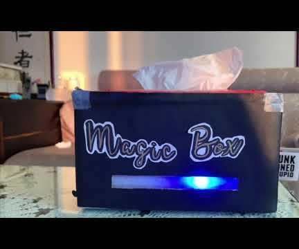

Step 2: Connecting the LEDs
I aligned them in a row and 2 holes from each other to have all 10 LEDs fit on the breadboard. The right side is the longer lead, the positive end, that connects with a digital pin. The left side is the shorter lead, the negative end, uses either a 220 or 100-ohm resistor connecting to the negative rail of the breadboard. The order and arrangement of the colors don't matter, you can place them based on personal preferences.
*Using a 220-ohm resistor gives you a smaller and more concentrated light while using a 100-ohm resistor seems a lot brighter compared to a 220-ohm resistor. So you can randomly change any color of light from a 220-ohm resistor to a 100-ohm resistor to show a sense of variety in your results.
Step 3: Coding
Connect the Arduino to your computer with the USB cable. The coding of the light show is here. The delays can be changed and the sequences can also be switched. Make sure your number of less is changed if you used more or less LED lights. As well as the pins of the less.
Step 4: Making the Tissue Box
