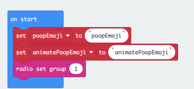

Step 1: On Start
On Start - set 2 variables: poopEmoji & animatePoopEmoji & radio set group to 1

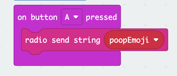

Step 2: On Button A
On Button A:  poopEmoji

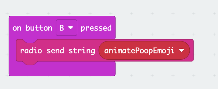

Step 3: On Button B
On Button B: animatePoopEmoji with short pauses to reflect animation, repeats 3 times loop

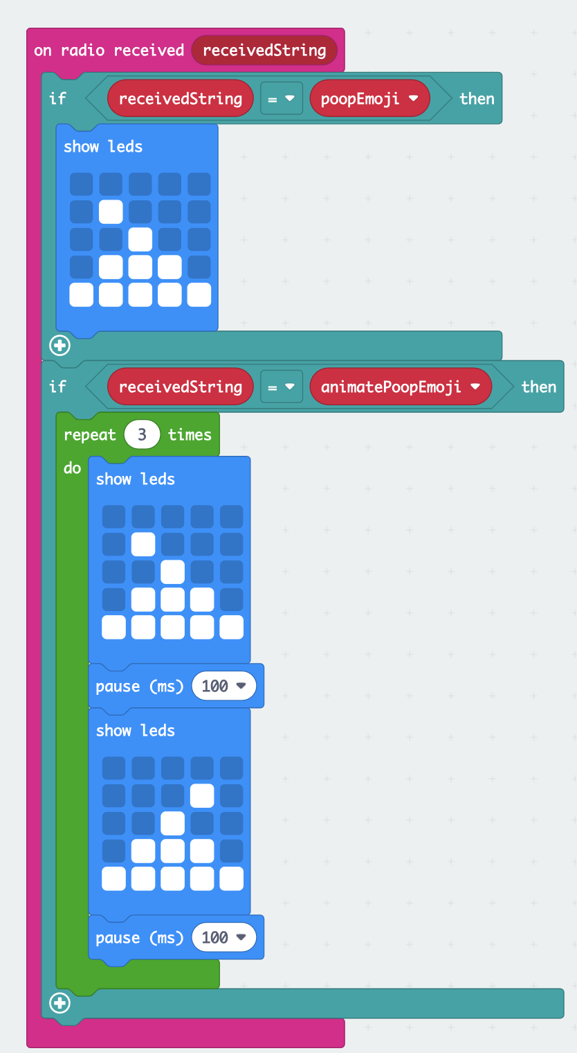

Step 5: On Radio Received
On radio received with the string with 2 If then logic for poop, animatedPoop with pauses and the loop for the animatedPoop
