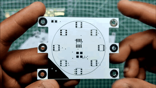

Step 2: Version 2 Design
I created the circuit by using the WS2811 datasheet's schematic as a guide, and I utilized 8 RGB LEDs linked in parallel with the IC.
To reduce the current flowing to the RGB LEDs and then to the IC, I placed two resistors between VCC and the RGB LED positive wire.
I added six CON1 Pins to VCC, GND, Din, and Dout in order to connect with this setup. (Two CON1 Pins each are linked to VCC and GND.)
I created the board layout after completing the schematic by placing all the LEDs and other components in the center in a circle so that they can subsequently be covered with epoxy. I built an 8mm-diameter through-hole pad with a 4mm hole to connect to this massive neopixel, allowing you to attach any metal plate or wire to it.

Step 3: PCBWAY
I sent the finished PCB to PCBWAY for samples after finishing it.
Since the WS2812B is white and the white solder mask looks fantastic in general, I decided to use it for this project.
The PCBs arrived in less than a week, which was impressive.
In terms of overall quality, it was outstanding. Each of the 20 boards I bought was flawless.
I've been using their service for a while, and I must say that the PCBs I received were excellent, just as I had hoped.

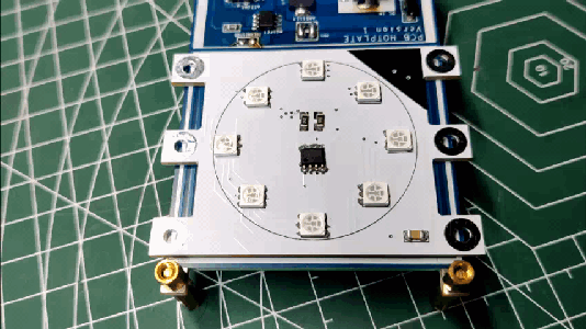

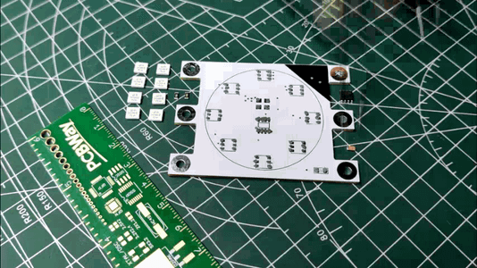

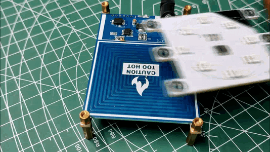

Step 4: Board Assembly
  • Board Assembly Process begins by first adding solder paste to each component pad one by one.
  • Next, using a tweezer, we pick and position each SMD component in its designated location.
  • Following that, we carefully lifted the entire circuit board and set it down on the Mini SMT Hotplate, which heats the PCB from below up to the solder paste melting temperature. As soon as the PCB reaches that temperature, the solder paste melts, and all the components are connected to their pads.
  • PCB is now fully assembled.

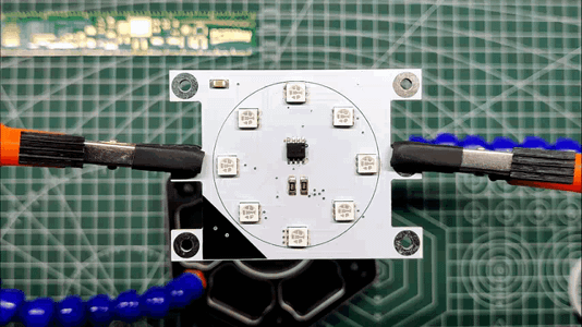

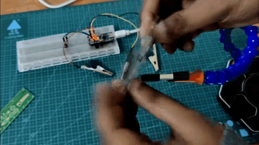

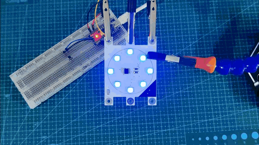

Step 5: Testing
We utilize three Aligator clips attached to jumper wires to test this arrangement. To connect the neopixel to an Arduino nano board, we attach the alligator clip to its rounded pads.
For testing this pixel, I've used Adafruit's Button Cycler code connected to an Arduino Nano.
Here's the code-

We connect LED's Din to D6 of Arduino Nano, VCC to 5V, and GND to GND.

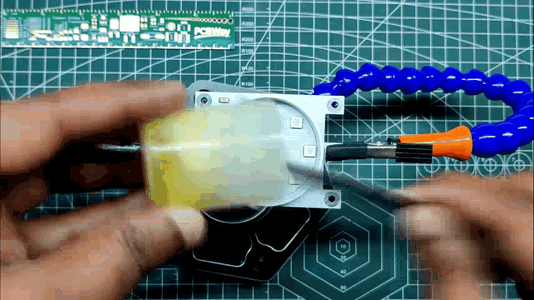

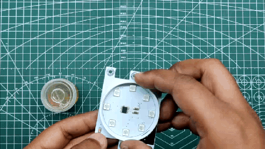

Step 7: Potting Process - Adding Border Ring to PCB
  • We use some super glue on one side and then add the 3D-printed ring to the PCB.
  • We then add super glue all around the ring's perimeter.
Filling the gap between the PCB and the ring surface with glue is crucial because epoxy could leak out via these tiny spaces.

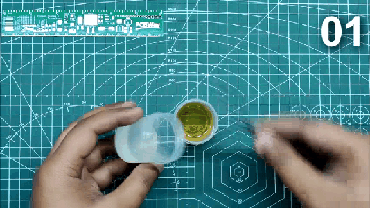

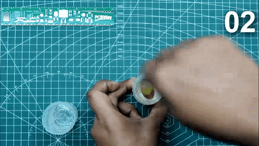

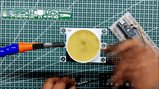

Step 8: Potting Process- Mixing the Epoxy
The hardener is added to the epoxy, and then they are combined. Their ratios must be equivalent; if not, the epoxy won't harden.

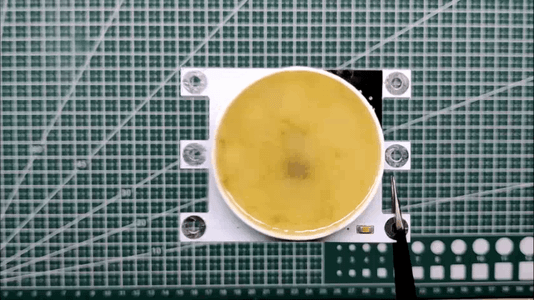

Step 9: Potting Process- Poring the Epoxy on Electronics
The epoxy is then added inside the ring using a flat tool, which is used to spread the epoxy uniformly over each of the components because it is thick and viscous.
After 15 minutes, gravity will perform the work of equally dispersing the epoxy throughout the structure, and we can then place this setup in the sunshine to cure the epoxy, which will take 1-2 hours depending on the quantity of epoxy.

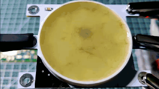

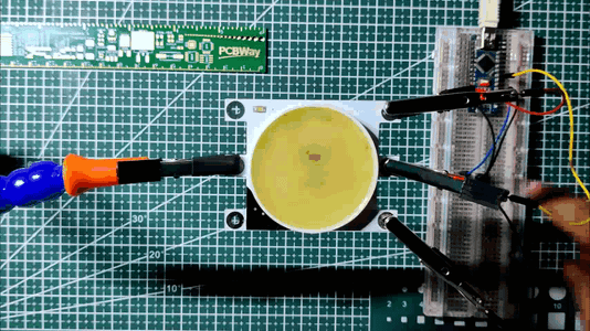

Step 10: Final Result
After a few hours, the epoxy will have cured, and we will have a huge Neopixel at our disposal.
The Neopixel is then attached to the Arduino Nano using alligator clips and tested once more by running the button cycler program used before.
