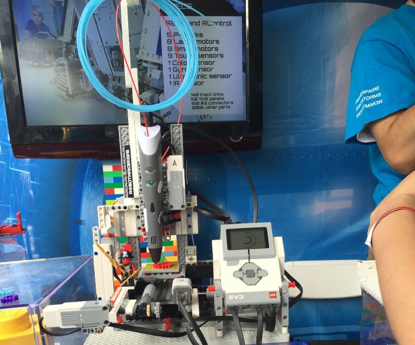

A basic, cartesian 3D printer using 3rd Generation ABS/PLA filament 3Dpen.
TECHNICAL DETAILS
Built using about 650 LEGO elements, including these special parts:
24 pcs 1x4 gear racks
2 x large Power Function linear actuators
3D pen
1 EV3 MINDSTORMS P-bricks
1 large motor
3 medium motor
3 touch sensors

Step 3: The 3Dpen
This robot is using Banggood's 3rd Generation 3D pen specifically.
You can get yours here:
No glue is being used in this version of the EV3Dprinter instead the pen is tightly fitting between LEGO elements.
