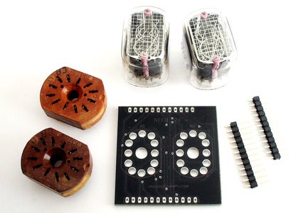

Step 1: Parts List
1 - printed circuit board
2 - IN-12A nixe tube
2 - IN-12A nixie tube socket
2 - straight 12-pin male header (1x12)

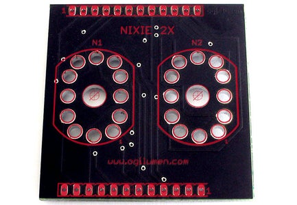

Step 2: Board Layout
The nixie tube boards can be assembled in less than half an hour. Note carefully to orient the nixie tube printed circuit board with the component side up. This is the side that will receive the two nixie tube sockets. The reverse side of the board receives the two 12-pin male headers. Also notice that there is an indent indicating pin 1 on each of the nixie tube sockets. This pin 1 corresponds to each pin 1 marked on the printed circuit board. Although the orientation of each socket has no effect on their function, this indent is present for reference, and allows you to quickly orient the nixie tubes.

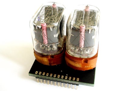

Step 3: Assembly
The following images offer a few hints that will assist with the insertion of the nixie tubes and the nixie tube sockets into the printed circuit board. This is the helpful part that you should not skip reading!! Before inserting nixie tubes or nixie tube sockets, ensure that each nixie tube will be oriented correctly. The numeral 3 is uppermost in the digit stack, and should help make this clear when inserting the nixie tubes into the nixie tube sockets. Most nixie tubes have a mark of some kind on pin 1, just inside the tube, letting you know how to insert the tube.
Step 4: Inserting the Nixie Tubes Into the Sockets
While it is possible to first fully insert the nixie sockets into the nixie tube board for soldering, it is then the more difficult to insert the nixie tubes into the sockets. To make this process less difficult, first partially insert the sockets into the nixie tube board, and then fully insert the nixie tubes into the sockets. The sockets can then be fully depressed into the board.
Step 5: Inserting the Sockets Into the Printed Circuit Board
It is very difficult to adjust the nixie tube sockets once they have been soldered to the printed circuit board. A good strategy is to first anchor a socket by soldering two opposing pins. In this way, the socket will not shift before all pins are soldered.
Step 6: Sockets Inserted
Use care to apply even force around the tubes and sockets to well seat them into the nixie tube board. Once the sockets are seated uniformly as shown, they can be soldered with best results.
