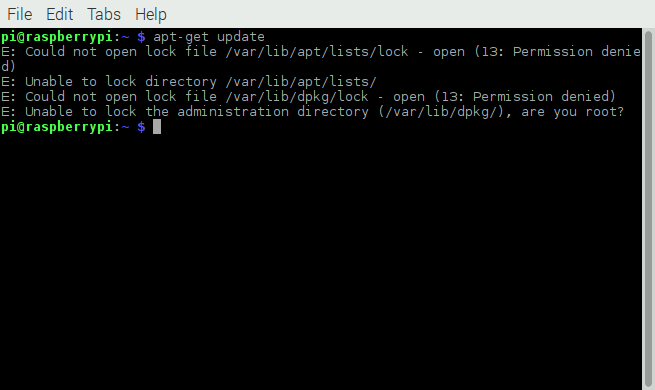

Before installing a software package, you need to first update the Raspberry Pi's current list of packages that are available to apt-get with apt-get update. Like so:
apt-get update

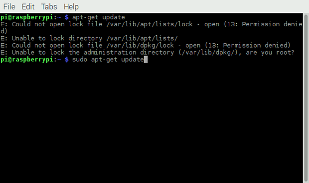

You will get an error saying "permission denied" and asking if you are root. Why is that? In order to make these kinds of changes to the Raspberry Pi's software, we need the permissions granted only to the superuser root. Luckily, you already know how to act as root while logged in as the user pi by using sudo. User accounts without root permissions will have to enter the root password to execute sudo commands.
sudo apt-get update
This time, the update will execute successfully.
Using sudo before the command.

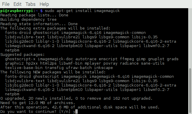

After updating, you are now ready to install a package. To download ImageMagick use apt-get with the install command plus the name of the package (don't forget sudo!):
sudo apt-get install imagemagick
Before the process completes, you will be told how much storage space the application will take up and if you want to continue. Type "y" for yes and then "enter".
Type "y" to continue install.

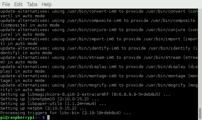

Install complete.

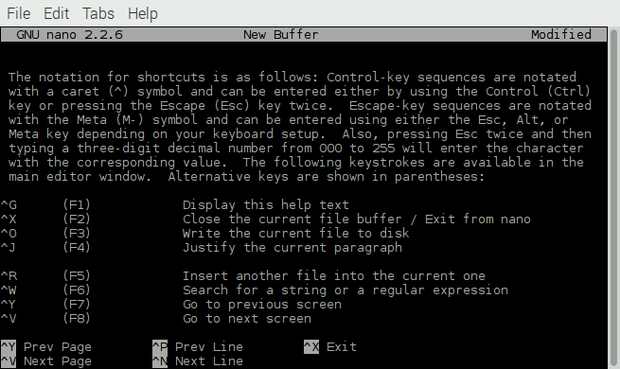

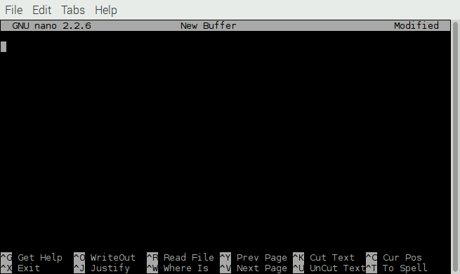

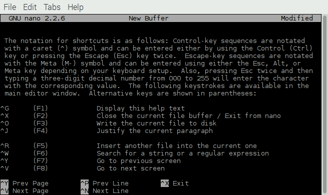

Let's start by opening a new file:
nano
This opens a new buffer which is the same as a blank unnamed text file. In the upper left corner, you will find the name of the application and version number. The name of the file is at top center which by default is called "new buffer". At the bottom of the window, there are three lines. The top line states the status of the file you are editing. Right now, it tells us that the file we are editing is a "New File". The two lines under that are a collection of keyboard shortcuts. The shortcuts you see are the ones most commonly used but there are many more. To see all the shortcuts available plus a description of how to use them, press Ctrl + G. This shortcut brings up the help page. To exit the help page press Ctrl + X.
As stated in the help page, to save a file press Ctrl + O. Alternatively, if you exit Nano using Ctrl + X you will be asked to save the file before exiting.

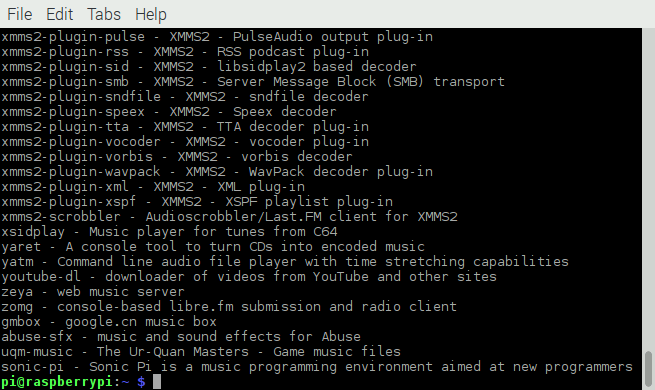

To search the available packages for a keyword, use search plus the keyword you would like to search for:
apt-cache search music
This will result in a list of packages that contain the word "music".

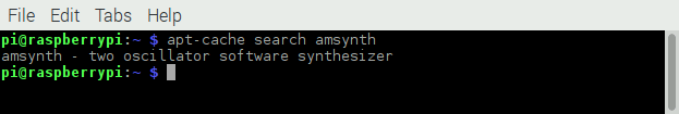

It also gives a short description next to each result which makes it a great way to learn more about a specific package if you already know the name. For example, I saw a package mentioned in an article called amsynth. To get a short description of what it is I can type:
apt-cache search amsynth

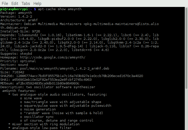

For a longer description along with version number, size, homepage, and more use show:
apt-cache show amsynth

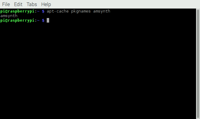

To search for a specific name of a package use the command pkgnames. If it is available, it will reveal itself:
apt-cache pkgnames amsynth

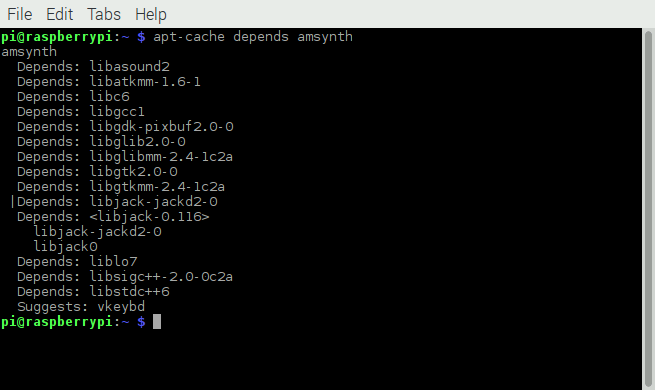

If a package has dependencies those will need to be downloaded too. To find the dependencies for a package use the command depends plus the package name.
apt-cache depends amsynth

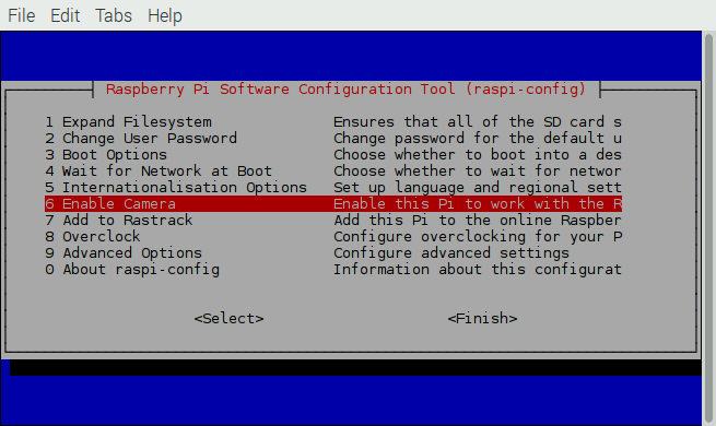

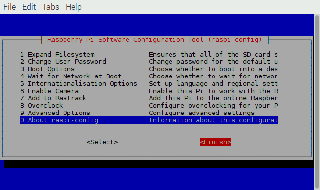

Remember when we went through and configured the Raspberry Pi through the desktop GUI? The Raspberry Pi can also be configured through the CLI using the raspi-config command:
sudo raspi-config
At the menu use the up and down arrows keys to move along the options. Use the right arrow to select Finish when you are done and ready to exit. You don't need to set up anything else for this class but now that you are quickly becoming a pro in LXTerminal you can put this in your pocket as a way to configure the Raspberry Pi.

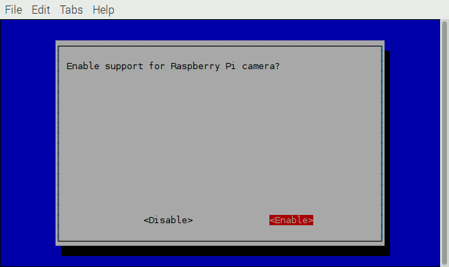

This is an example of how to enable the camera with raspi-config (no need to enable it, you already did in the Get Set Up lesson).
