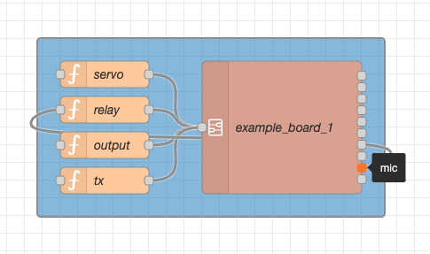

Each board will be pre-programmed to connect to Node-Red, we will cover this in a following step, for now I want to talk about how to connect inputs without having to re-program the boards. This is what you and your students will be doing to design your interactions.
Node-Red is a node based programming interface, this means that instead of writing code and functions, you link them together visually. You can still write code if you need to, but from a basic level, you don’t have to.
We made up our own node to represent a board. As you can see, they have multiple inputs and multiple outputs. If you hover over the outputs, you can see what they represent.
[image 1]
Make sure to update the name of the board to your boards name, to do this you can double-click on the board, this will open the side menu where you can type the name. Click Done and then Deploy. Every time you make a change, remember to “Deploy” it for it to take effect.
