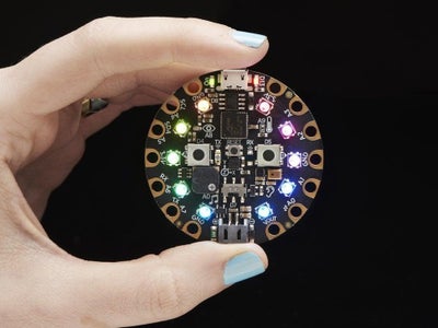

The supplies you will need to complete this project are a 3D printer, Circuit Playground Express, Servo, Cardboard, Push button, Blue wires, solderable breadboard,USB-C cord and the website Adafruit Makecode.

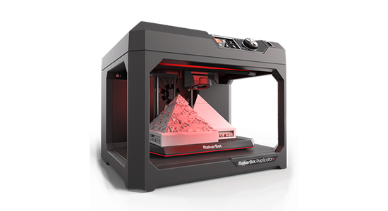

Step 1: Print the Parts
Using this link below print the 3D parts using a 3D printer, located in a classroom or the Makerspace. A printer with supports is needed.

Now, we need to wire the circuit playground express to our mouse trap. The servo will be placed on top of the trap, the 3 wires connected to the servo will control it. Most importantly the wire in the A1 slot. The A1 wire is going to tell the servo to move while the other two wires provide it with a flow of electricity for it to work. The servo motor is a functional tool, which helps to control the movement of the trap.
  • In order to connect and assemble the servo motor, we are going to place the servo into the holder hole facing towards the entrance hole, the wires connect to the ground port, 3.3v port and the control wire is connected to one of the control ports.

  • On make code, under the input section you will select "On button A click", then connect the block to "set servo A1 angle to 0 degrees."
  • You are going to repeat this step using another block from the input section that says "On pin A6 click" and connect that to block "Set servo A1 to angle 60 degrees."

In order to download the code we have to follow two simple steps:
  1. Connect your board via USB and enter bootlander mode. To do this press the reset button once on your CPX to put it in bootlander mode. The LEDs will turn red briefly, then green.
  2. Next, click the download button and it will generate a .uf2 file, then download it to your computer!
