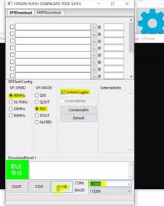

Step 2: Install CADIO Firmware on ESP8266
To make this project, first, you must install the Cadio Firmware on ESP8266.
  • The CADIO dynamic firmware for ESP8266 NodeMCU is available to download from the Downloads Center.
  • ESP8266 CADIO firmware consists of a single binary file located at the address 0x0.
  • SPI flash mode is DIO.
  • SPI flash speed is 40MHz.
  • Make sure that the DoNotChgBin checkbox is activated.
  • You should erase the current flash before start flashing the firmware to avoid any issues.
  • Now click on Start to install the Cadio Firmware.
