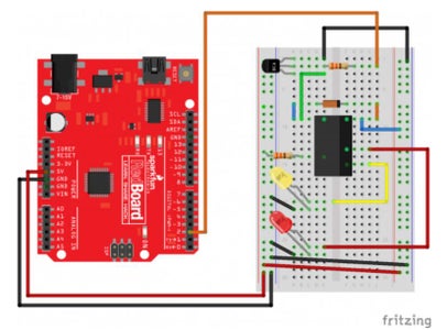

Step 8: (OPTIONAL) Assemble Arduino Uno With Relay and Air Pumps
If you want to go a step further and make your air pumps automatic, you can use Arduino with relay to code a device that switches between the air and vacuum pumps at a desired time interval.
Follow the attached tutorial from SIK Kit Experiment 13: Using Relays.
  • Assemble the Arduino and breadboard according to the schematic, replacing the LED's with the two pumps.
  • Copy/translate code to latest version of Arduino software.
  • Connect board to computer and upload code.
You can play with the time delays to simulate different breathing patterns for an inhale and exhale.
***NOTE: This step is optional because it is much more difficult to carry out effectively. I was not able to get enough power to my board to get an automatic version fully working, but altering voltage and resistance accordingly should eliminate this issue.
