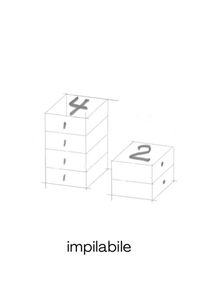

Design of a steel-milled press for a stackable mould with numbers pressed from plastic. The aim is to create an open-source design that can be produced locally in educational institutions. With the help of a press milled from steel and insert plates, various number moulds can be produced. An educational toy that grows with the child, which initially serves as a mobile and hangs above the child's bed and later as a stackable toy.
The stackable moulds can initially be placed above the children as mobile elements to promote visual perception. They then serve as interactive toys that can be used not only for stacking but also for learning numbers.
This project combines manufacturing techniques, material science and pedagogy to create a sustainable and educational solution that can be produced and customised locally.

Modular design: The press consists of various modules that can be easily joined together. This allows a easy assembly and disassembly as well as easy customisation of the system to interchangeable figures.
Mathematics Learning: The press aids in teaching numbers through the creation of stackable figures. Children can engage in hands-on activities, enhancing their understanding of numerical concepts. A builded tower can be used to visualise the number. This enables a variety of educational applications and promotes children's understanding of numbers.
