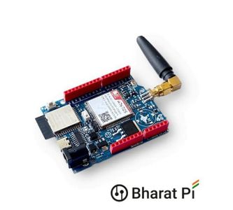

In this project, we are using Bharat Pi which has both an ESP32 microcontroller and a SimCom A7672S 4G/LTE module.
Bharat Pi is an IoT prototyping board for students, innovators, startups, and developers. A simplified board with an all-in-one compute, network and storage on a single board to build rapid prototypes.

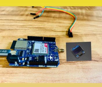

Step 1: Schematic – ESP32 With OLED Sensor
In this section, we will see how to connect OLED sensor with ESP32. The OLED sensor will be connected with the ESP32 board with its pins.
Follow the schematic diagram for the ESP modules and connect them accordingly. Connect the ESP32 device with the OLED sensor as shown in the schematic diagram above:
Pinout of the OLED Sensor :
OLED Sensor - ESP32
VCC - Power Supply
SDA - SDA
SCL - SCL
GND - GND
Wire the OLED sensor to the ESP32 as shown in the following schematic diagram. We’re connecting the vcc pin to 3v/5v and the sda pin to sda, scl pin to scl pin of esp32 and GND pin to GND of esp32.
ESP32 Wiring With OLED Sensor :
OLED Sensor - ESP32
VCC - 5V / 3V
SDA - SDA
SCL- SCL
GND - GND
