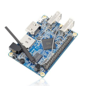

1. OrangePi Lite (https://www.banggood.com/it/Orange-Pi-Lite-with-Quad-Core-1_2GHz-512MB-DDR3-WiFi-Mini-PC-p-1101903.html)
2. USB Keyboard and Monitor with HDMI cable only for first setup
3. Power Adapter for OrangePi Lite (not an USB one as OrangePi Lite as this board doesn’t take power from USB ports)

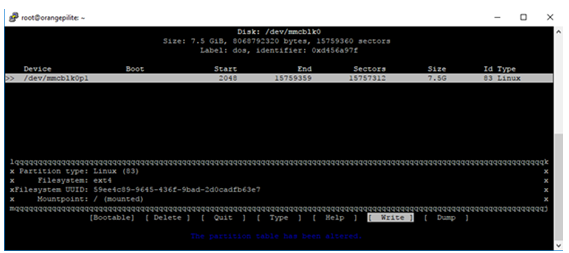

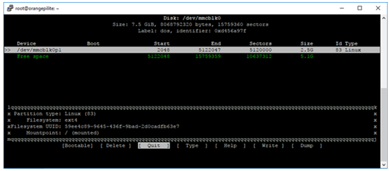

5. Type the command “sudo cfdisk /dev/mmcblk0
6. Select the partition called "/dev/mmcblk0p1" with the arrow keys and then select DELETE
7. Make a new one that will use the full size of your sd card.
8. Select WRITE and type YES when confirmation is required.
9. Select QUIT and press Enter.

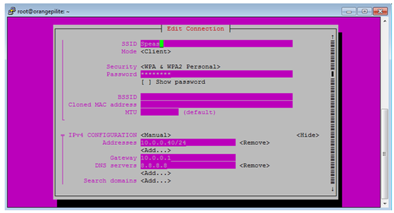

13. Log in again and run the command “nmtui”, a network utility will help you to connect to your WiFi network following the instructions.

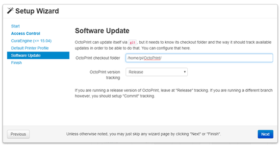

4. When in Software Update tab add /home/pi/OctoPrint/ as your git update path.

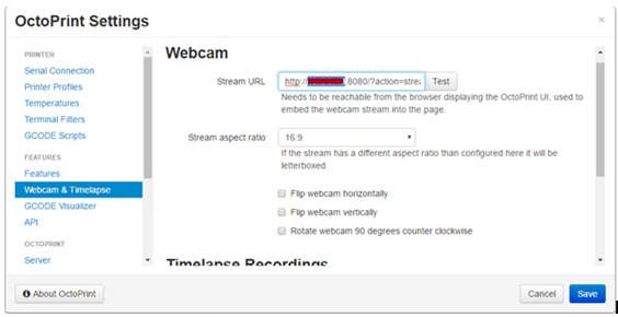

5. in Webcam & Timelapse tab replace IP address with your own

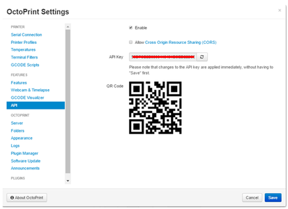

1. To setup login to octoprint and from Settings and API tab copy API key

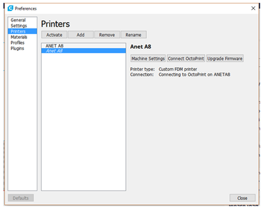

2. Then open Cura and go to Preferences Configura Cura… - Printers. Select your printer and press Connect Octoprint.

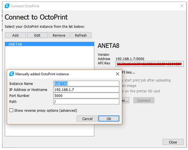

3. click Add to setup a new Octoprint instance; fill in Name, IP and Port Number, than input API key.
4. Now you can send prints directly from Cura and monitor status and video streaming.
