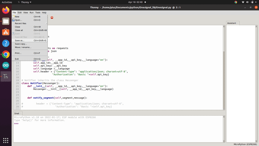

Step 2: Adding the OneSignal Library to the File System
I am using Thonny ide, so I will be explaining using Thonny.
Open the onesignal.py file in Thonny, go to file and click “save as”.
Then click on "micropython device" and type in the name of the library as “Onesignal.py” and click save. (Make sure your esp822 or esp32 is already connected to your PC).
