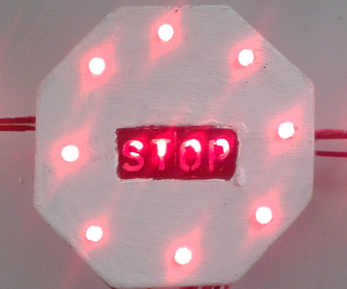

In this project, we will make a circuit that flashes two red LED's alternately when the gate is open.

In simpler terms, we will connect a push switch to the gate and once the gate is opened, the switch releases, switching the circuit on.
The circuit will then flash the two red lights alternately indicating that the gate is open.
I will expand on this a bit by connecting the battery that will power the circuit to some small solar cells, so that the battery stays charged.
So we will be making :
a push switch
a multivibrator circuit
and a small solar charging array.
