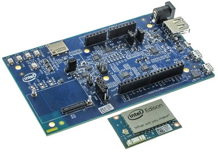

Just stack all the shields, from bottom to top: Intel Edison dev board, GROVE Base shield and your sensors.

First you have to prepare the Intel Edison, please flash the latest firmware, then access to serial terminal and configure the system and the wifi network. You can do this by following the steps of the official documentation of Intel: Intel Edison on the arduino board

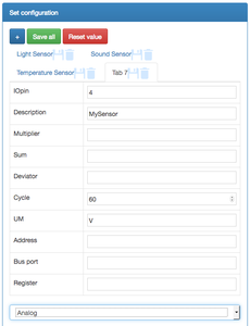

Configuring sensor table, from setup page, enter the required information, enter the correct pin number to which the sensor is attached, title and time interval.

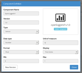

Now, we connect and upload data from your Intel® Edison to the cloud-based analytics system provided on the IoT Analytics site. Read this article for activate you account.
Add a catalog for each sensor connected to Edison. It is important that the name corresponds to the number of the sensor Id. For example, the sensor with ID 1 will have the following component name: OpenLoggerID1
Look at the figure as an example.
