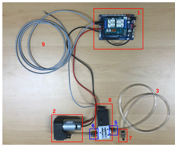

Step 19: Set Up the Vacuum Gripper
Follow the Vacuum gripper set up using OpenCR guide page.
