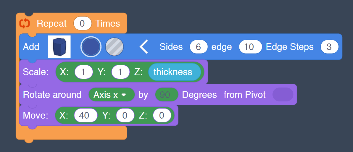

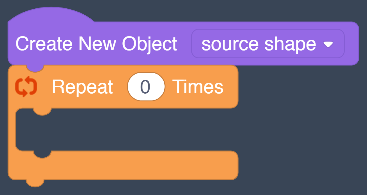

Start by adding another Create New Object block and naming it Source Shape. Add a Repeat loop. We will be making several shapes to use with the generator - we use the Repeat block to toggle on or off the blocks that create a particular shape. Set a repeat to 0 and the code in the loop is ignored; set it to 1 and the code will run! (This does the same thing that "commenting out" your code does in text-based programming languages.)
Add a shape - we'll start with a polygon. Click on the arrow icon to expand the options for the shape. Set the sides to 6, edge to 10, and steps to 3 (this will create a hexagonal prism with slight bevels on the top and bottom edges.) For now, match the parameters of the example - if you start changing things now, later steps will probably need adjusting and it could get messy. It's better to get the code working first and then come back to put your own spin on it.
Let’s get familiar with the 3-axis coordinate system in Tinkercad. The Origin is the center of the grid where X, Y, and Z all equal 0. It can be hard to tell by looking, but the axis lines all start on the workplane. When a shape is added it is centered on the Origin with half of it below the workplane. You can see a white shadow where the shape passes through the workplane.
Now to adjust and position the shape. Add a Scale block - it multiplies the dimensions of the shape for X, Y, and Z directions.Use the thickness variable for Z. Whatever we set in the thickness variable at the top will now change the height of our source shape.
Add a Rotate block to rotate the shape 90 degrees around the X axis - this simply turns the shape so it is standing up.
And lastly, add a Move block. (This isn't entirely necessary, but it helps with troubleshooting later if the source shape is not in the way of the ornament while your code runs.)

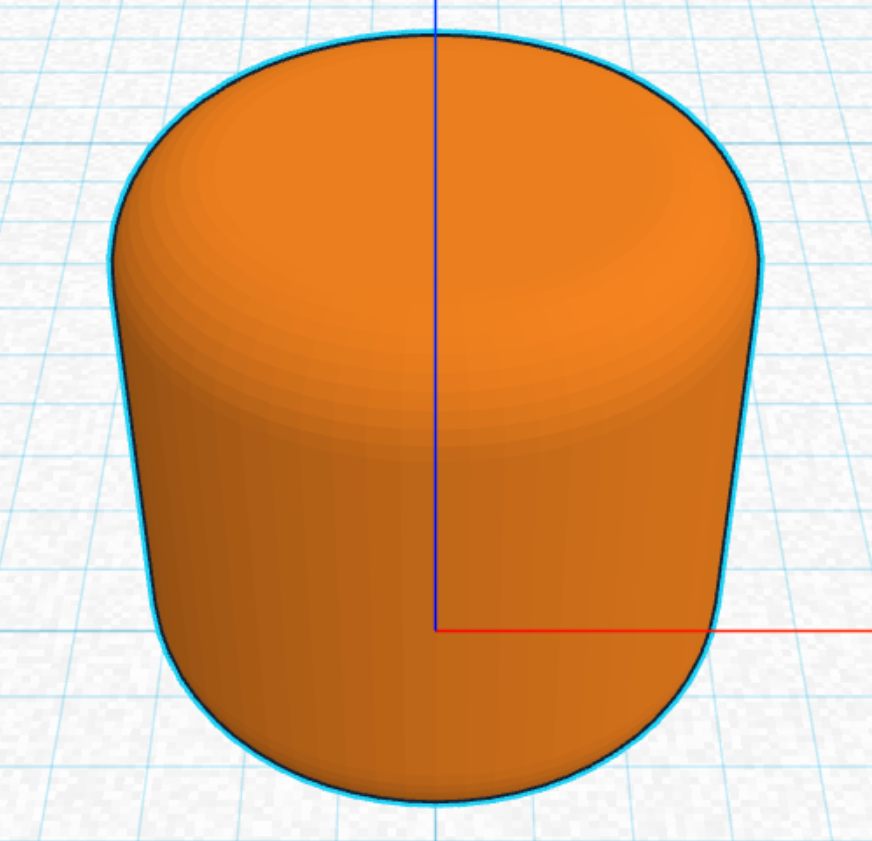

First, add a Create New Shape block and name it cap. Then add a cylinder with a radius of 3, height of 6, and sides to 64. Set the edge to 1 and the edge steps to 24 - this creates a nice rounded edge on the top and bottom of the cylinder. Add a Move block to bring the bottom of the cylinder up to the top of the workplane.
Now we need to cut the cylinder in half. Add a box, make it a hole, andset the height to 6. Remember that the box is created centered on the origin - only the part above the workplane will cut the cylinder. Add a Create Group block to make the cut!

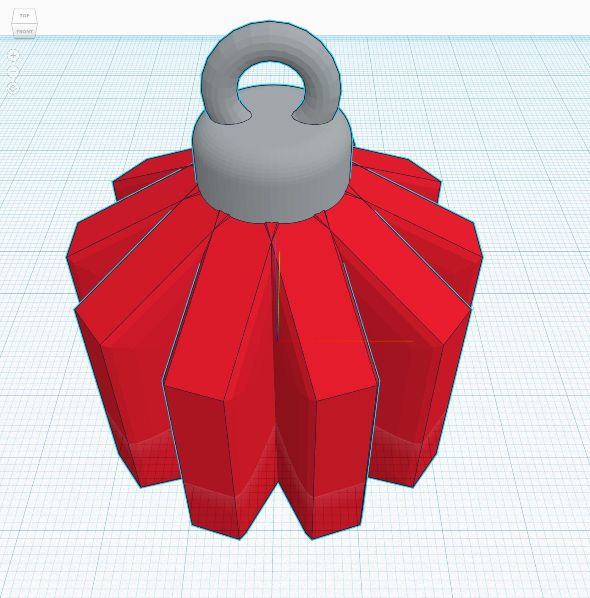

Next add a torus and a Scale block set to .25 - remember, the scale value is a multiplier. This will shrink the torus down to 1/4 size.
Add a Rotate block and a Move block to put the torus in position with the cap.
Add a Create Group block and set the color - the color is just so the torus and cylinder parts appear as one piece in our design.

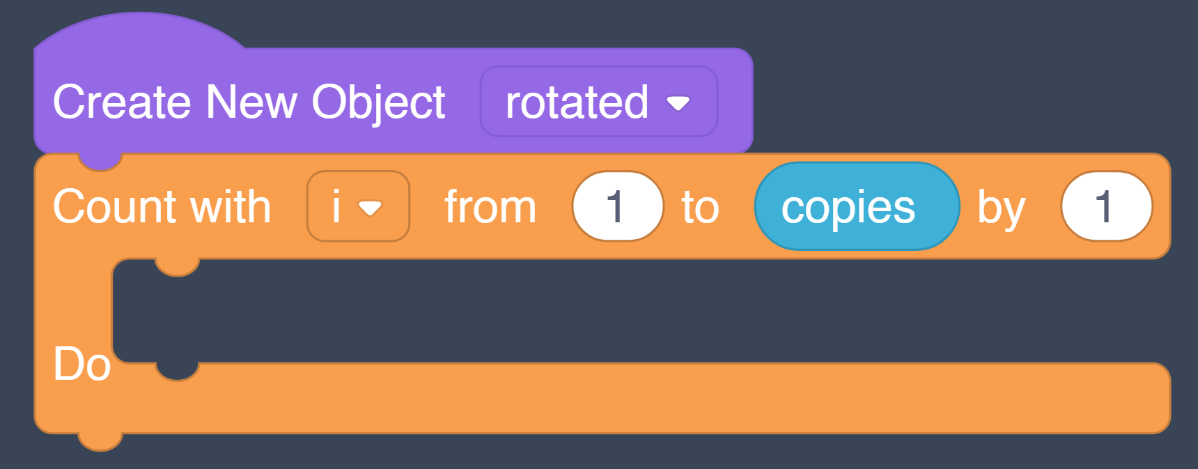

Start with a Create New Object block. We'll call it rotated. Add a Count with loop. This loop will allow us to do something a certain number of times, and each time the loop runs the variable i will increase. We want to have i start from 1 and increase by 1 each time the loop runs, until it gets to the number of copies set in the copies variable. We will use the i variable later in the loop!
Add a Add Copy of Object block and select source shape. (Setting the color of the copy to something different than our source shapes lets us tell the copies apart from the original if something goes wrong with our code.) Add a Move block to place the copy back on the Origin and shift it up to meet the cap that we positioned earlier.
add a Rotate block. Here's where that i variable comes in handy - we can rotate each copy based on which iteration it is. Starting from 180 degrees, we divide by the number of copies to figure how many degrees each piece should be rotated away from each other. If we stopped our math there, every copy would end up in the same place. By multiplying by i, we can rotate each copy to right spot!
Why 180 degrees and not 360? Each shape is pivoting around the Z axis from its center, meaning we only need to calculate for one side of the circle - the other 180 degrees of the circle is made up of the other half of the shape.

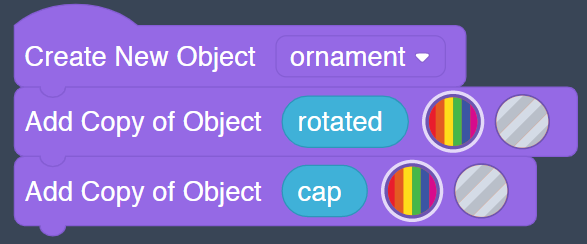

In order to group the body of the ornament and the cap together as one object, we have to create a new object called ornament and add an Add Copy of Object block for each shape.
Now we will add a block, set it as a hole, and then set the height of the block to our trim variable. This will cut the bottom of the ornament flat to make 3D printing easier.
To make our trim variable be the actual height that we want to be cut off the bottom of the ornament, we need to move the block up so it is on the workplane with a little math - we know the height of the block above and below the workplane is the same, so we have to move it up by half, or the quotient of trim ÷ 2.
Lastly, we create a group, delete the rotated and cap shapes (since we made copies earlier in this step), and then scale up the ornament to a slightly larger size.
