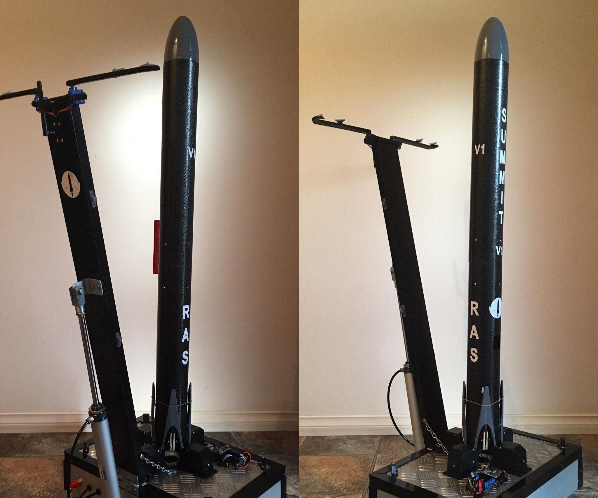

Well my model rocket isn't exactly a typical rocket with fins and a basic launch pad with a guide rail. Instead the rocket is filled with custom electronics and thrust vector control equipment. Thrust vector control, or TVC, involves moving the engine inside the rocket to direct its thrust and therefore steer the rocket to its appropriate trajectory. However this involves GPS guidance which is ILLEGAL! So my rocket uses TVC to keep the rocket super stable going upright with a gyroscope on the flight computer, no GPS equipment. Active stabilisation is legal, guidance is not!
Anyway through this long intro I still haven't explained what the controller does! The launch pad as I previously said is not just a stand with a guide rail, rather a complex system filled with electronics a mechanical parts, like a real launch pad. It includes a pneumatic piston to retract the strong back, clamps holding the rockets base and upper body and many other things which I will explain better in future YouTube videos.
