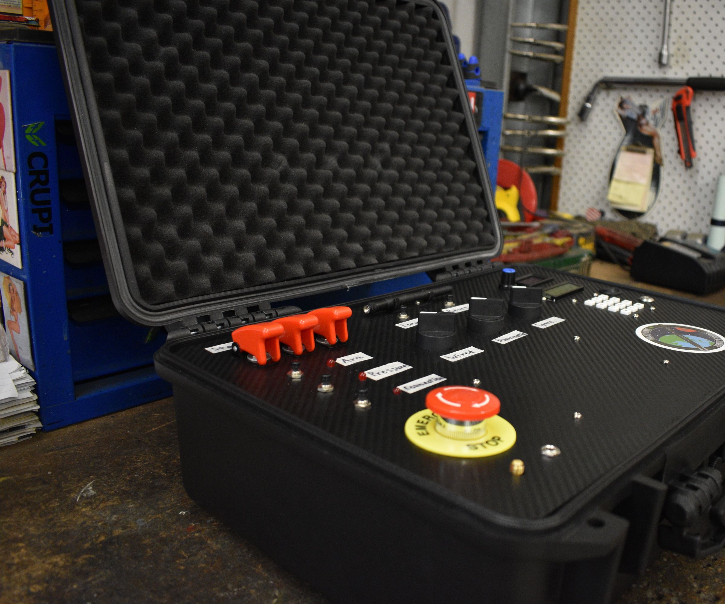

A while ago I released an Instructables post about my ‘Overkill Model Rocket Launch Controller’ along with a YouTube video. I made it as part of a huge model rocket project where I am making everything as overkill as possible, in an attempt to learn as much as I possibly can about electronics, programming, 3D printing and other forms of making. The Instructables post was very popular and people seemed to like it, so I decided it was worth making one about my new overkill launch pad!
