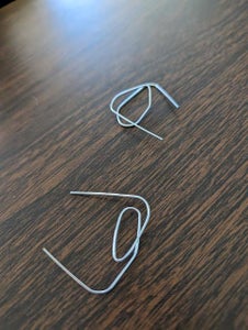

Step 2: Bend Paper Clip Legs
Using your hands or pliers, bend each of the three paper clips around one of the craft sticks. Allow an equal amount of paper clip to be on both sets of the loop created by the craft stick. This will create three sets of legs. Similar to an insect, this robot will have 6 legs total. Note: Regular paper clips are pictured, but in my experience, vinyl coated paper clips are much easier to bend. Also, this step doesn't have to be done perfectly. The legs can be bent and tweaked at the end to best support the robot. When trying this design, my students managed to bend the paper clips without pliers. They were pretty grumbly over this step at first, but ultimately figured it out.

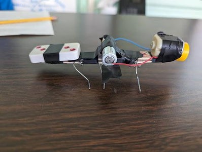

Step 5: Attach Motor Assembly to Front of Robot
Determine what will be the "front" of the robot. Tape the entire motor securely to the craft sticks at the front of the robot. Make sure the spindle and offset motor weight is hanging off the front of the robot so it will be able to spin freely. Note: This step is the most common source of troubleshooting for students. At the end they may find their design isn't working because the craft stick is in the way of allowing the motor to spin. It will spin once and get stuck. If this happens, they may be able to push their motor forward. Or, they may have to cut the motor off and re-tape it in a better position.
Step 6: Attach Battery to Body and Motor
First find the perfect placement for the battery. This is where both wires from the motor can reach both ends of the AA battery. Once the perfect position is determined, tape the battery to the body of the robot. Next tape the metal end of one wire to one end of the battery. Make sure the metal on the end of the wire is in full contact with the end of the battery. Then, tape the second wire end to the other end of the battery. This should make the motor spin, so be ready! Last, un-tape one of the wires as shown in the picture. This tape/wire will be the on-off switch for the robot. Right now it is in the off position. Tape the wire back when you want to turn the robot back on.

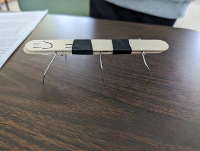

Step 7: Add Counterbalance and Tweak Legs
If needed, add a counterbalance. If your motor wires were as short as mine, it is likely that your robot is front heavy and unbalanced. A variety of different objects can be taped to the back of the robot for balance. The robot design in the picture uses a domino. Brainstorm possible other counterbalance ideas. For example, you can fold an origami paper box to tape to the end and add coins. Or you can design a small box to 3d print. The easiest solution is to use materials you already own.
After adding a counterbalance, bend the legs as needed. Pliers can be very helpful during this step. You can bend the end of each paper clip to add a "foot". A couple of different student leg designs are shown in the second photo.
