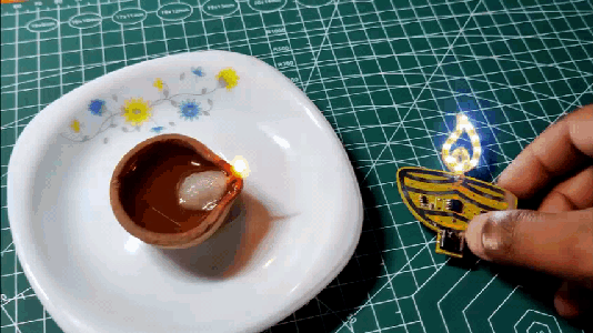

So here's something HOT, a PCB DIYA that is powered by an Attiny13 MCU, it has two different LED Driving Mosfets that turn ON and OFF LEDs in a sequence and that emulate a flame.
This Instructables is about the whole built process of this PCB so let's get started.

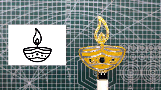

Step 3: PCB DESIGN
I started the design process by first finding a nice black-and-white image of a DIYA which can be used as the base model for the whole board.
The Black and white image that was selected got converted into BMP Image as my cad software only imports BMP format for creating a new silkscreen layer.

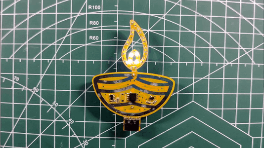

Next, I prepared a simple Schematic with other Attiny13A MCU that had two Mosfet as Switch setup, One Mosfetr that only had 4 LEDs connected in series was the AO3401 N channel mosfet which can handle 4A of current at 30V max.
5V will be used here if powered by the USB port and 3V if powered by the Coin cell.
For 10 LEDs, the same mosfet as switch setup was utilized but with the 8205A Mosfet IC that has two mosfet on it, I connected both in parallel so it can handle a total of 12A, and 6A each at 20V which is too much for this system but keep this in mind, always choose components with at least double the current usage of your project requirement.
As for the design, I added LEDs in the Flame region, 10 LEDs were placed at the outline of the flame and four at the inside region, Flame also has a cutout between two LED regions.
As for the current limiting Resistor and Diode of the USB Type C Port, both are placed on the bottom side of the board because of space issues.
ISP Connector is an SMD Con6 Port that is made especially for using a POGO Pin setup for flashing this board.

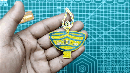

Step 4: PCBWAY
After finalizing the board, I exported the Gerber Data and sent it to PCBWAY for samples.
A yellow solder mask and white silkscreen was used for this project.
I received PCBs in a week and the PCBs were nice as expected.
I really like the quality of the white solder mask, it was a tough sample to manufacture as the silkscreen that I laid out on this board was not completely symmetrical and I also added a few cuts in the flame region which was definitely not like normal PCB layout but PCBWAY did an excellent job of manufacturing this PCB with no error whatsoever.

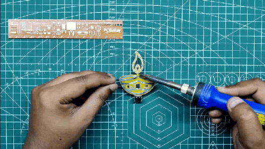

Step 5: Solder Paste Dispensing Process
We apply solder paste with a solder paste dispenser syringe or the proper method is to use stencil here which I don't have. but anyway, after this, we can now move on to the next process, which is to add components to each pad.

Next, we carefully pick all the components with an ESD tweezer and place them in their assigned place one by one.
  • We start first by placing Microcontroller, Mosfet IC, Mosfet, and resistors.
  • Next, we add LEDs in their place which was the flame region.

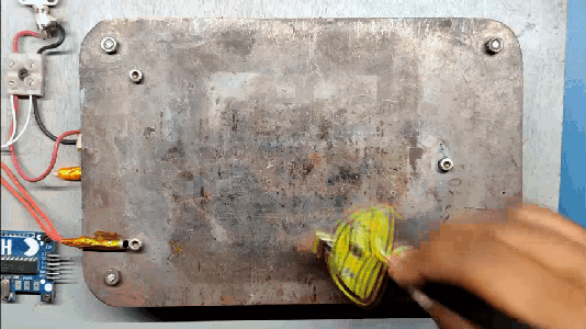

Step 7: Hotplate Reflow Process
Then after doing the pick and place process, we carefully lifted the whole PCB and place it on the hotplate. I’m using my good old DIY hotplate which I made a few months ago.
Basically, in this hotplate reflow process, the surface heats up to the solder paste melting temp and it slowly melts. after a few mins when the solder paste completely melts, we remove the PCB and let it cool down for a moment.

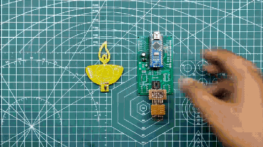

Step 9: Main Code and Attiny13 Programming
I have used an Arduino as an ISP programmer which I made last year. it's basically an Arduino nano that has its SPI Pins breakout for connecting Attiny13A with it in order to flash the Attiny MCU.
As for connecting Attiny13A, it connected through six Pogo Pins that are connected with ISP Pins of ISP Programmer.
If you want to know how this setup works then definitely check out this post of mine. https://www.hackster.io/Arnov_Sharma_makes/multiple-attiny85-13a-programmer-84adf8

To Flash Code to the Attiny13, we first need to wire the Arduino as ISP setup with the Custom PCB Badge in the above configuration.
  • We first select the right MCU which is attiny13 in our case and do not forget to choose the right com port.
  • then we select the right programmer which is in our case "Arduino as ISP"
  • then we hit on the Burn Bootloader option which will take a few seconds
  • Now we go to the sketch menu and select the "Upload using Programmer" Option and BANG.

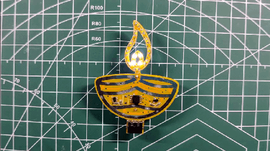

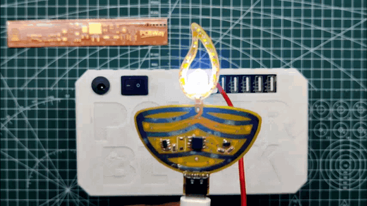

Step 10: Power Source #1- 5V Supply Via Type C Port
After Programming, we connect a 5V Source to the USB Type C Port of the Circuit for powering the setup.
For this Test, I'm using one of my previously made PowerBank that can provide up to 3Amps at 5V but the device consumes a bit less, roughly 1 Watt.

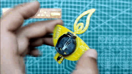

Step 11: Power Source #2- CR2032 Cell
After testing the USB Section of the DIYA PCB, we move on to a much better and more portable solution which is to add a Coin cell Holder to this board and run it via a CR2032 Cell.
We add a CR2032 Coin Cell holder in its place from the bottom side and solder its pad with a soldering iron, the polarity of the Coin cell holder should be right so we should always double-check while putting the THT Coin cell holder in its place.
Step 12: Conclusion
This PCB DIYA works and is a perfect Desk Decorative prop, it even looks better than an actual clay DIYA.
As for LEDs, RED or Orange LEDs could be used instead of White or we can use two color tones of leds so it will look a lot more like a flame.
