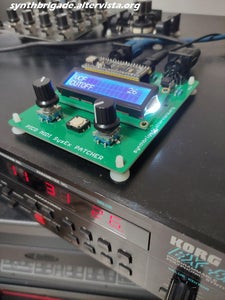

Step 1: Programmer Features
PICO MIDI SysEx programmer main functions are:
  • Built-in LED display
  • Simple operation with only two rotary encoders and a push button
  • MIDI input, for serial operation
  • Open Firmware
Yes, technically those rotary encoders have a built-in push button and actually are-in-use, so the button count is "three", not "one".

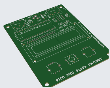

Step 2: Hardware Description
Interface
In this programmer I wanted to adopt an opposite approach with respect to the previous project: The interface elements are here kept at a minimum, with only two rotative incremental encoders and a menu button (ok: three buttons).
It may seem a step backward reducing the number of knobs in a programmer born to face the lack of programmability of mid '80s synths. It's not if you consider the sinergy with a firmware where all parameters are reasonably cathegorized (see next Step) and a LED display showing in real time the patch parameter cathegory, name and value.
LED Display
A reasonably sized LED display makes the patching more pleasant, especially if you want to spend time on it. My previous hardware programmer project is equipped with a tiny OLED display. It is enought for that hardware because information displayed are limited to the sequence properties, but in this case all patch parameters names are visible, without the need for a comparison sheet.
Microcontroller
As said, the microcontroller in use is the Raspberry Pi Pico. This microcontroller is powerful both in terms of computational power (up to 133Mhz, dual core) and memory storage (up to 16Mb). That huge - as per today standards - memory allows to include verbose strings in the firmware, makeing the new approach adoptable.
The Raspberry Pi Pico is also cheap, at the moment, soo...
MIDI
Both MIDI IN and MIDI OUT circuits are built-in.
MIDI OUT is mandatory to be able to send MIDI messages and in no way could be left out.
MIDI IN is necessary too, because the synth could not otherwise receive messages from any other instrument (i.e. master keyboard or DAW) when the programmer is connected. This means that patching and sequencing phases would be necessarily separated/distinct. With a built-in MIDI IN circuit you can have both a sequence running and the possibility to modifiy the patch at the same time (i.e. you could send a nice filter sweep in real time).
The MIDI IN circuit is an opto-isolated circuit respecting the MIDI association specifications. Nothing new under the sun.

Microcontroller Board
I have already sung the praises of Raspberry Pi Pico microcontroller board. Here I want just add a warning. There exist two versions of this microcontroller board (if we neglect the fact that you can buy it with memory ranging from 2Mb to 16Mb). Here I have been using the 30 pins clone, which has a different pinout with respect to the official Pico. At the moment, the 2Mb version is sufficient.

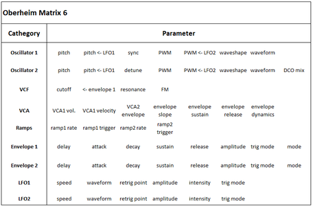

Oberheim Matrix 6
The Oberheim M6/M6r is the most advanced synthesizer of the lot and features an incredible routing complexity even compared with nowadays instruments.
The time tought us that "complexity" can be a two blades knife in the musical production world, and the absence of direct parameters manipulation possibilities makes the Matrix 6 one of the most underrated "sounds factory" out there in terms of sound engineering.
Of the 99 parameters the synth supports, "only" 52 have been included in the Programmer firmware. I cathegorized them into 9 groups:
  • Oscillator 1
  • Oscillator 2
  • Voltage Controlled Filter
  • Voltage Controlled Amplifier
  • Ramps
  • Envelope 1
  • Envelope 2
  • LFO 1
  • LFO 2
See Step header sheet for details about subcathegories.
I tried to limit parameters to a reasonable number by leaving out of the equation the third envelope, track points, clicks, etc. It would be possible to handle them all, anyway, thanks to the Raspberry Pi Pico memory size.
Parameters not handled by the Programmer are not "disabled", but accessible through the synth panel, anyway!
The Matrix Modulation was too complex to be included, so it was left out.
