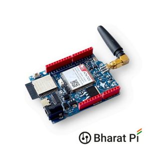

In this project, we are using Bharat Pi which has both an ESP32 microcontroller and a SimCom A7672S 4G/LTE module.
Bharat Pi is an IoT prototyping board for students, innovators, startups, and developers. A simplified board with an all-in-one compute, network and storage on a single board to build rapid prototypes.
