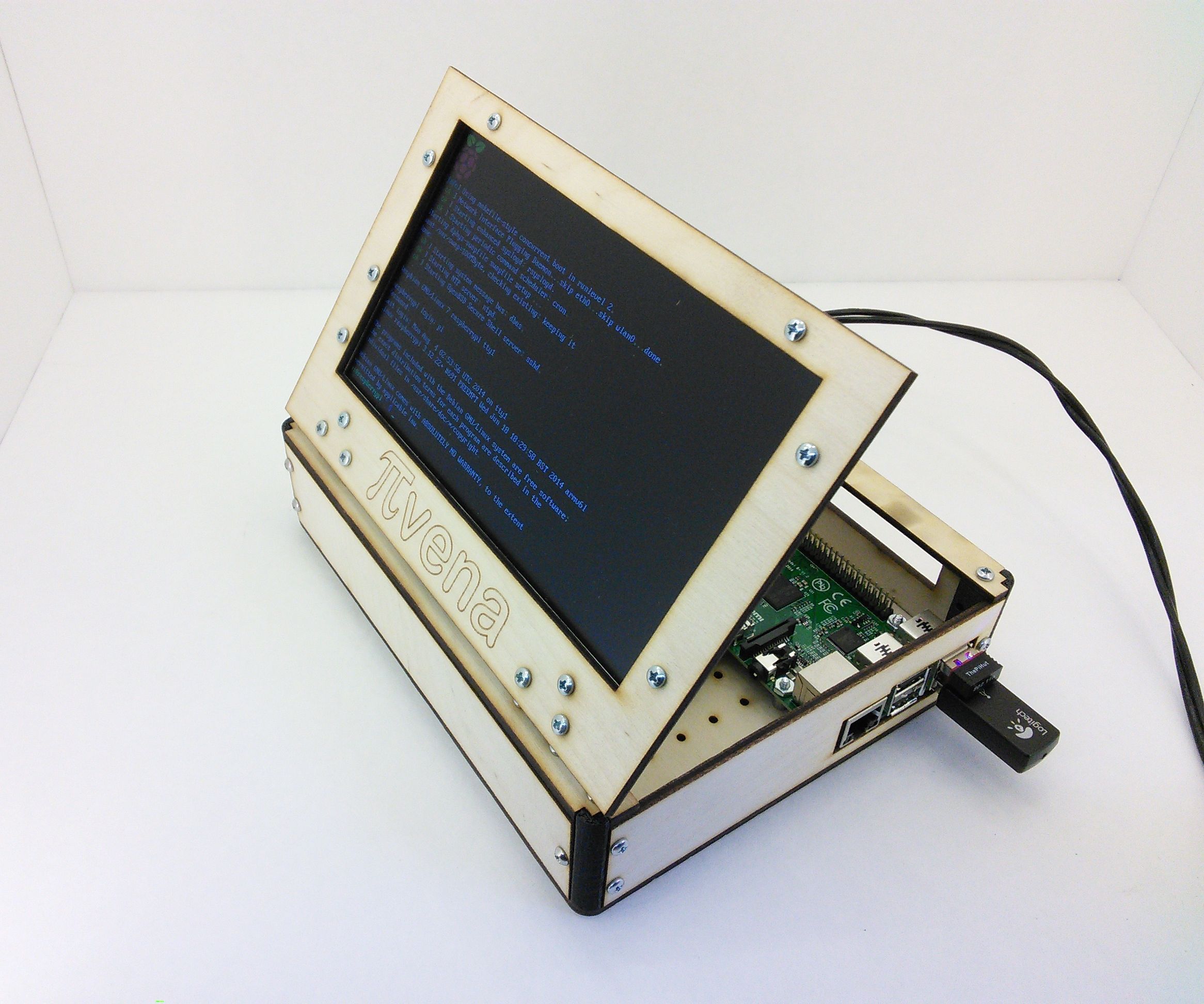

Step 2: Assemble the Base
  1. Get the base plate, (4) 5/16" screws, (4) 3D printed corners
  2. Set the base plate down in the orientation shown in the first picture.
  3. Insert one of the 5/16" screws from the bottom side of the base plate in a corner hole
  4. Screw it into the bottom of the 3D printed corner piece
    1. NOTE: the bottom of the 3D printed corner is flat, while the top has a bump up that is used to align the top pieces.
  5. Repeat for the remaining 3 corners

Step 6: Right Side
  1. Grab the side plate (has 2 square cut outs), (3) 5/16" screws
  2. Slide the side plate between the 2 3D printed corners. The USB and Ethernet ports should line up with square holes in the side
    1. If it isn't fitting on nicely you may need to rotate the 3D printed corners slightly.
  3. Use (3) 5/16" screws to secure the side plate to the 3D printed corners.

Step 15: Last Step! Install the Front Plate
  1. Grab the Front Plate and (3) 5/16" screws.
  2. Install the front plate
  3. Use (3) 5/16" screws to secure the front plate to the 3D printed corners.
Hurray! You've successfully built your very own PIvena! Congratulations on being awesome!
