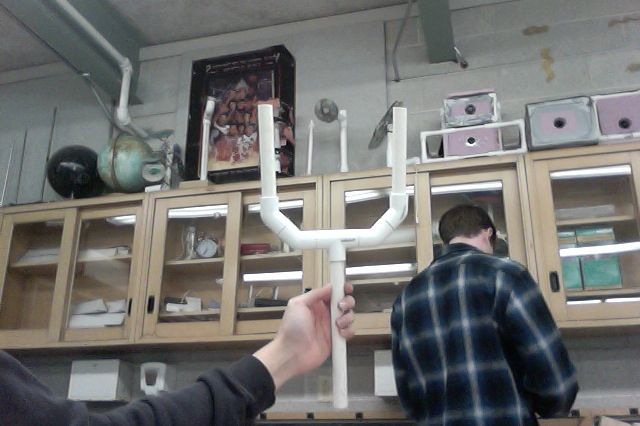

Step 3: Assembling the Back of the Wheelchair
(complete all these steps for both sides)
First take the two 3 way connecters and connect them using a 18" piece of PVC(as seen in the picture). make sure to have the connecter facing the right way or else you may need to repeat this process. after those are connected from the top of those add the 23" pieces and leave them the way they are for now. then from the end that has nothing attached slip in a 2' piece of PVC and then slide a tee connecter facing upwards to the exposed side of the pipe. squeeze this together so that no pipe is visible anymore. once this is done you will need to add another 2" piece to the top of the tee connecter. after that put a 18" piece of pipe in between two Tee w/side outlet connecters and then slide this onto the exposed end of the pipe.(make sure once again that the connecters are facing the right way. make sure they look exactly as they do in the picture). once this is done add a 4" piece onto the top of the Tee w/side outlet connecters, then put regular tee connecters on top of that at a slight outward angle(the bent PVC will be placed there later). Then add the next tier using a 3 1/2" piece and putting regular Tee connecters facing outwards as seen in the picture. next step is to add the last 4" piece of pipe and then two more Tee connecters to the top, at the same angle as the ones below it so that they achieve the same angle.
Now for the cap, or top portion of the back. add the last 4" piece to the top Tee connecters and cap those of with 90° connectors facing backwards. using the last Tee connecters w/side outlets attach them together with a 18" piece of PVC, and then slide them onto the top portion of the back of the chair. lastly stick the last 2" pipe in between Tee connecter w/side outlet and the 90° connecter to finish the back of the chair. The exposed portion of the back of the chair is where the handles will be placed later.
