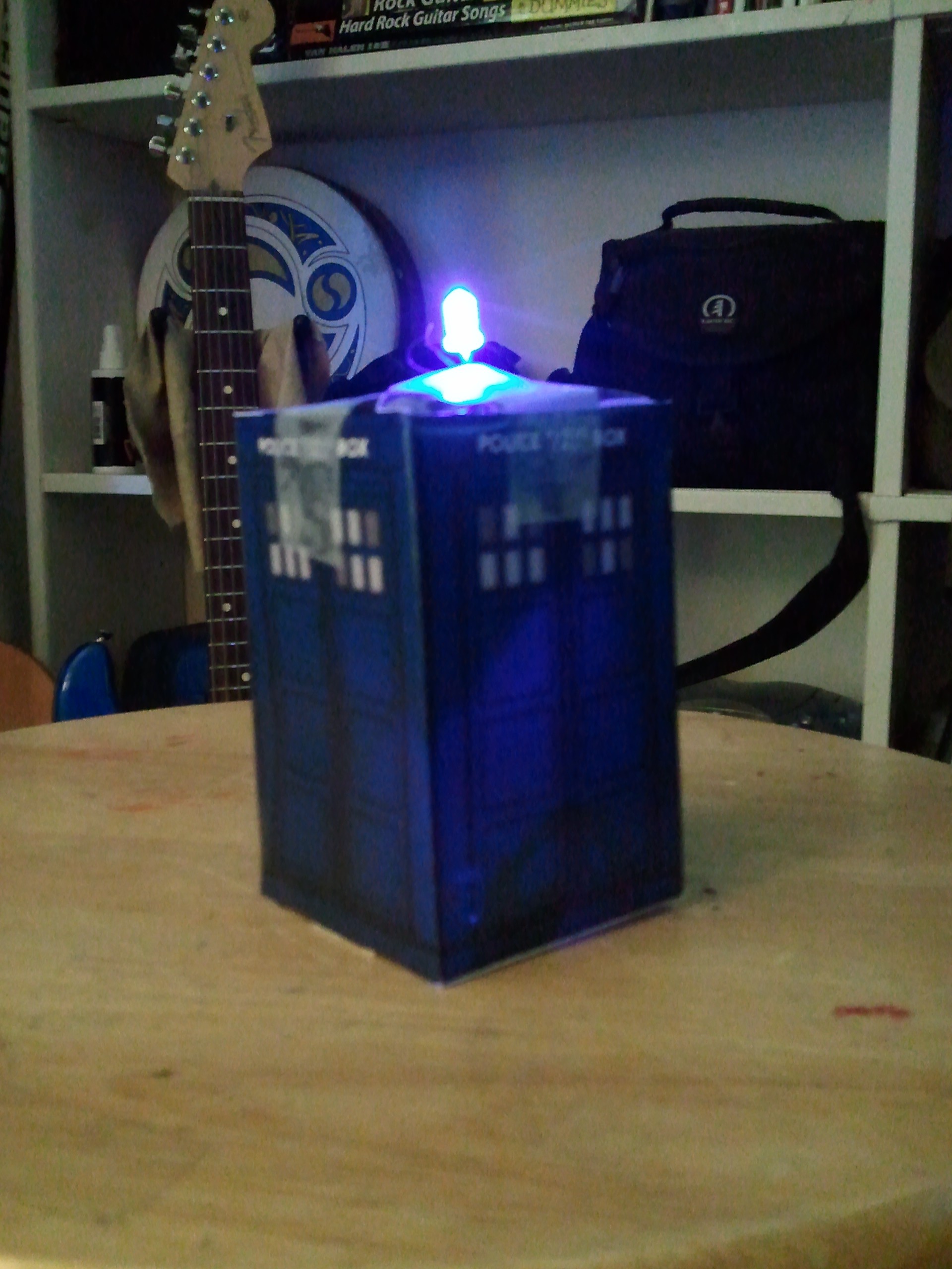

Here's a simple papercraft project for any whovians with a little down time. It took me about 20 minutes to make it but it was well worth it. To add some extra realism I put a blue LED at the top to seal the deal. This is going to be my entry for the Scoochmaroo papercraft challenge.

So hopefully you have all the sides attached to the bottom and top of the TARDIS. Now you just have to secure it using either tape or glue whichever you decided to use. That steps pretty simple so I'm not going to spend anymore time explaining it. I want to get to the trickier part which is making the LED circuit and attaching it to the TARDIS. Once it's all taped down cut a hole in the top big enough for a 9volt battery to fit through. Now put the TARDIS to the side and get ready to build the LED circuit. If you chose not to do the LED part you can just attach the top piece and call it a day. However if you're up for putting in the LED read on.
Step 8: (optional) Wiring the LED
This is an extremely simple LED series circuit. You will need a blue LED, a resistor, possibly 22gauge wire (depends on how long the 9v clips wire is), 9v clip, and a 9v battery.
The resistor value will be determined by the LED's voltage and current rating also the 9V. I can't tell you what resistor to use without knowing more information on the LED. Therefore just use ohms law to find the resistor value needed.
R= (9v-LED's voltage) / LED's current
once you have all the components connect the resistor to the short wire on the LED. The short wire is the negative side and the long wire is the positive. You don't have to solder them you can just splice them by wrapping the wires around each other. Connect the red wire to the long side of the LED and the black wire to the resistor that's all there is to it.

make sure the circuit is working and the LED is on. Now slide the 9v battery in the hole we made earlier. Make sure the LED is sticking out and isn't falling inside the TARDIS. If it is make the wires longer so it won't fall in. Now take that top piece we saved and punch a hole in it if you haven't done so already. Slip the LED through the hole and tape down that top piece.
