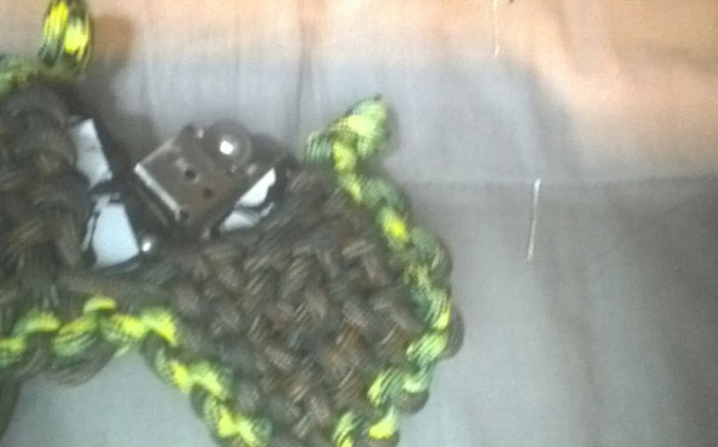

in this 'ible i will be showing you how to make a paracord lighter pouch like the one in the photo above. This lighter pouch is made specifically for Zippo brand lighters and is different to most lighter pouches of any kind as it allows the lighter to be  easily opened without taking off the pouch. This project is surprisingly simple and fun so please try it and post a photo in the comments =P.

Step 2: Starting the Cobra Wrap/Weave
To start this project we will need a 8 foot length of paracord. Having already done this project i would actually recommend 9 feet because i only designed this with 8 feet and it was only just long enough. to start with, make a mark in the centre of the cord (i used a silver sharpie to make the mark) and then make 2 more marks, each 9 inches from the centre mark, this is where you will start the wrap.
1. First make a loop in the left length of paracord, just above the mark, then pass the remaining length under the right length of cord.
2. Make another loop with the right most length of paracord making sure it wraps around the left paracord and end underneath it.
3. Now pass the right paracord over itself and through the first loop made with the left length of cord.
4. Pull tight
You have now made your starting knot. Don't let go of this and move onto the next step

Step 4: Weaving the Sides
I cut a 20 foot length of cord for the weave and only ended up using less than 10 feet of it so is only suggest cutting 10 feet or maybe a bit more if you like to make your weave very loose to begin with. It was around here that my paracord bundle collapsed into a big ugly heap =( oops. To weave the sides i used a large blunt needle but i know that you can buy paracord specific needles for relatively cheap. if you are using a blunt needle, the way i threaded it was by melting one end and flattening it, then i passed it through the eye, melted the end again and made a stopper. This worked surprisingly well.
Steps to create the weave
1. Mark the centre (again).
2. Wrap the cobra weave around your zippo and find the top corner.
3. ALWAYS THREAD THROUGH THE OUTTER LOOPS OF THE COBRA WEAVE.
4. Thread half of the cord through one topmost corner of the weave to the other topmost corner.
5. come back out and then thread the cord through the next hole down.
6. continue in this manner until you reach the hinge of the zippo where you should make the cord go out one hole of the hinge side and back into the next hole of the same side instead of the next hole of the opposite.
7. now continue like you were doing before until you get to the bottom most corner.
8. IMPORTANT!!! This corner should be the one furthest away from the hinge. If it is, good for you. If it isnt you will either need to take out one weave or add another so that you end away from the hinge. This is where your own judgement will come into play.

Step 8: Finishing the Sides
i then threaded both ends of the cord into the inside of the pouch, cut them to length, melted them and then shaped them into stoppers. Sorry about the pictures, it6 was very hard to get my camera to focus on the inside of the pouch =3.
Step 9: Finishing the Pouch
To finish the pouch i added an 80 cent leather button on the side which i covered in fabric glue and water with a ratio of 1:1. I explained why i used fabric glue in the materials section of this 'ible. The glue was still wet when i took these photo's and it looks alot better now.
Step 10: And We Are Done
So i guess thats a WRAP. I tried to WEAVE a few puns into this 'ible here and there to keep things interesting but I'm aFRAYED that no matter how hard I tried I could KNOT find a smooth way to do so. hope you had fun and please try this project. I appreciate all constructive criticism and if you do find a way to do this better, post a picture in the comments so that everyone knows =3. Thanks for taking your time to read this 'ible and please VOTE FOR ME in the paracord project.
