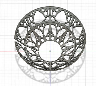

Step 6: Parametric Pattern Design
With the vessel 3d scanned and represented by flat surface curves that can be unwrapped, it was now time for the design stage. To support pattern creation, I created a workflow that sections the area into a number of slices, and replicates the design created in one slice around the piece. I did this by creating a circular pattern rotated around the y-axis and selected the profiles sketched in the original slice. For the design shown above (and for other symmetrical patterns shown in this project) I also created a midpoint construction sketch line constrained to 1/2 the arc length which was used to reflect the design created on one half across the line for a symmetrical slice.
I wanted to support designing patterns for both interiors and exteriors of vessels, so I created two workflows that allow sketching on the xz plane (flat plane - interior) or the xy plane (vertical plane - exterior). In the case of the second workflow, the slice boundaries are sketched on the xz plane and projected along the y-axis to the vessel surface. The design is then similarly rotated around the y axis at plane angles that map to each slice.
The photos above show the sketches rotated then extruded through the surface faces to visualize the resulting design.
Step 7: Emboss Pattern + Unwrap Surfaces
I had hoped the sketches could be extruded through the sheet metal faces to apply the pattern, however that appeared to break some sheet metal rule that prevented the faces from successfully unwrapping as a flat pattern. I looked into different solutions here and ended up going with the 'emboss' feature that supports transferring sketches to curved surfaces. After experimenting with embossing, I switched up my process from the previous step slightly- I embossed the original slice on the faces, then replicated that "feature" through a circular pattern rotated around the y-axis.
I was then able to select each face individually and "unwrap as a flat pattern" which I exported as a .dxf file. The final embossed designs for each piece I created are shown above.
