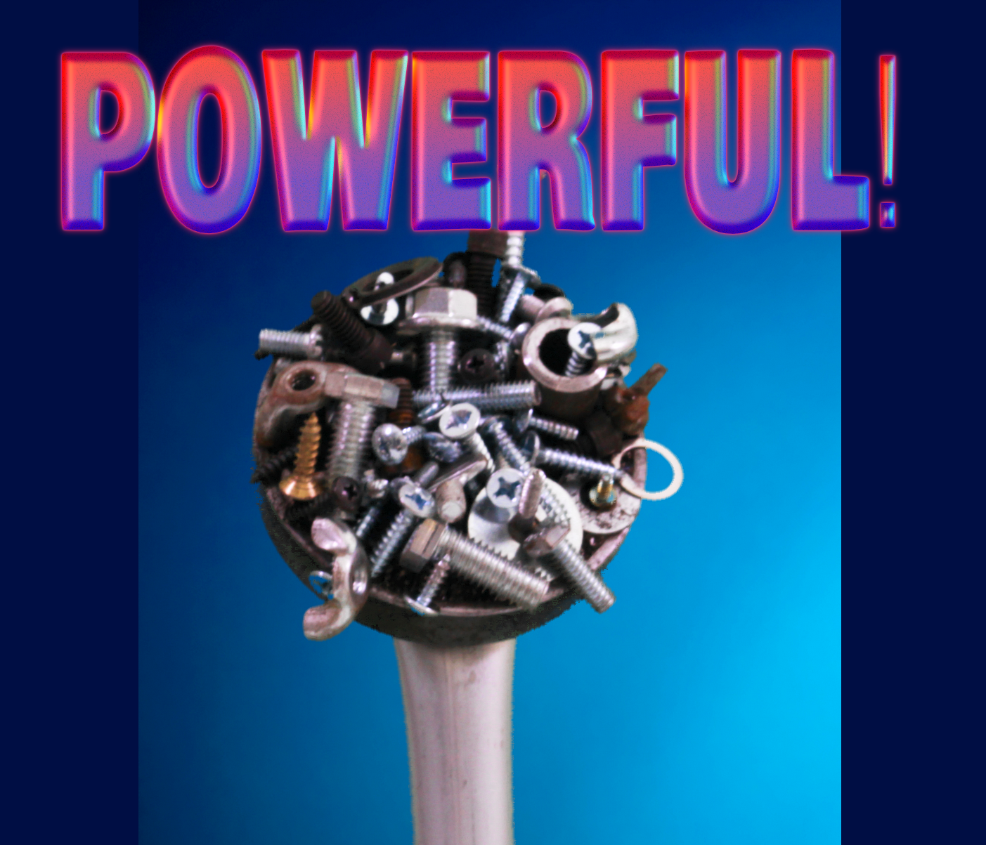

If you are like me, you spill things like nuts and bolts and small parts. If they are magnetic, you can pick them up with a magnet along with the other magnetic items such as sharp shredded metal shavings! Then you have the chore of separation of the parts and the sharp metal. "OOOOUUCH!!.. Where's the Bandaid??
"If they are made of rubber, plastic, or non-magnetic metal such as brass, copper or stainless steel, you can just sweep them up along with all the dust and dirt in a dust pan! You end up hand picking out your now dirty parts, which may now have to be cleaned!
Today I documented my first prototype of the PVRS which anyone can duplicate and improve for their own needs!
I personally love it and plan on making a smaller more portable commercial version. (Retrieve-It ™ Patent Pending)
