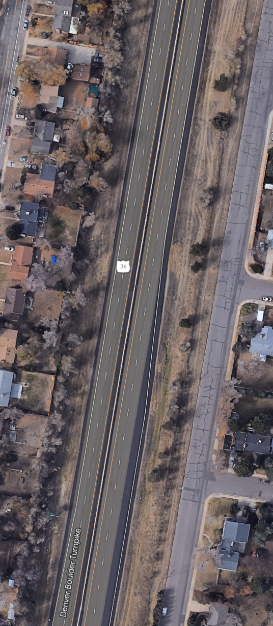

Step 1: Figuring Out the Location
For this bridge pick a highway that splits two neighborhoods. I chose two neighborhoods in Boulder Colorado. These neighborhoods are split by Highway 36. In my case, the highway also split schools, so there were schools on either side of the highway but these schools specialized in different things. One is a very art-focused school and the other is very academic. I thought this bridge would do a great job of connecting both of the communities as well as giving the people on either side of the highway easy accessibility to both these schools (including the other schools that have been split by this highway). This bridge will provide a large green space as well.

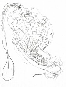

Step 3: Identifying Potential Problems
This step is very important because before the bridge can be built you have to look at what might go wrong to prevent it and evidently make the bridge safer. There is no need to create solutions for these yet that will be done later and if new problems arise that is okay and part of the process. My concerns were (in no particular order):
  1. ventilation for car emissions will look unsightly and out of place in the neighborhoods.
  2. The highway is elevated so it will need to be dropped rather drastically
  3. the bridge will force the road under too much and make the tunnel transition very drastic.
  4. there is a river that runs under the bridge so the bridge will have to come up fast enough to miss the river or the river will need to be redirected.
  5. Flooding in the tunnel.
  6. the tunnel will be too low.
Step 4: Creating Solutions to the Problems and Goals
These are the solutions I came up with the problems solutions are stated first then the goals order:
PROBLEMS SOLUTIONS:
  1. For car emissions, there will be carbon dioxide filters along the walls. These filters were made in Switzerland and they suck the carbon dioxide out of the area and get rid of it. according to sience.org, the gas can then help in greenhouses and carbonating drinks. There will be a community greenhouse on one side of the bridge to facilitate the use of gas and bring the community together. On the other side of the bridge will be a regular community garden to grow other things during the warmer seasons. Finally, any other gasses that can't be filtered by these machines will be released out of vents placed along the edge of the nearby roads to look like drainage ditches. These vents will push gas out while others push air in these were techniques used in the Lincoln tunnel. Each one will be placed in the place where the houses aren't such as on the north side of the bridge where the neighborhood transitions into a prairie and on either side near the other busy roads to reduce the pollution going into neighborhoods.
  2. The road being dropped too low will be fixed by allowing it to go over the creek a bit lower because the only reason the road isn't lower is because of the bike path, but the bike path will be rediverted to go over the bridge so that is no longer a problem. The road also starts lower (about 6ft (1.8m) lower than it ends) so it only needs to drop about 22ft (6.7m) instead of 28ft (8.5m). The road is a highway so the speed limit is 60 miles/hour (97km/hour) and it is a straight away so people tend to go faster so in order to make the transition seamless as possible the speed limit will be dropped to 55 miles/hour (88.51km/hour) with multiple warnings.
  3. To prevent flooding in the tunnel the road will be slightly humped to redirect the water into grates on the floor that will drain the water from the tunnel. The water will then be directed down a sloped passageway to the middle of the bridge where it will be dropped into pipes and redirected to boulder creek where most of the water in Boulder is let into. The boulder creek then empties into the Mississippi River.
  4. Things that became irrelevant: the tunnel having to miss the river became not a problem because it was only that big of an optical because of the bike path but the bike path can now go over the river. Finally, The tunnel being too low (for trucks and other vehicles) never became a problem because after figuring out how high the bridge was on some of the other bridges coming into Boulder it didn't have to have as much clearance as I thought.

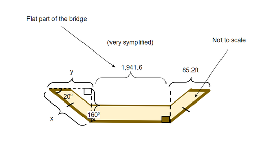

Step 7: Getting the Dimensions for the Bridge: Part B

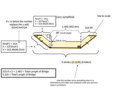

This part of finding dimensions will mostly be focused on the length of the bridge. There are two main parts in the length part 1 is the long flat part of the bridge/tunnel and part 2 of the length is the two ramps on either side of the bridge. The dimensions are below and separated into those two parts. Notes: the bridge/tunnel is shaped like an equilateral trapezoid on its back.
Part 1 dimensions:
Length - 0.28 miles (0.45km)
Thought process:
To figure out how far the bridge will stretch go onto google earth and pick a house or building where you want the bridge to start and pick one where you want it to end (add a little bit of room for error I added about 20ft(6.1m)). Then, get directions from one place to another using any direction software to figure out how far this bridge will stretch. For reference, I chose the starting point a little bit after the last exit/on-ramp and the end point a little before the creak that runs under the pre-existing road. This part of the bridge is a straight stretch of road with no on or off-ramps so I did not have to worry about that. The bridge/ramp will be 0.4 miles (0.64 km) long so with both ramp lengths subtracted the bridge/ tunnel should be 0.23 miles (0.45km) long.
Part 2 Dimensions:
Ramp length - 315.4ft (96.01m)
How much the ramp covers - 314.6ft (95.89)
Thought process:
The first thing is to figure out the angle you want the ramp to be. For reference, 90 degrees is a straight drop or a cliff, and the closer you get to 0 degrees (a flat road) the more gradual the ramp gets I chose 4 degrees for the ramp. Next, since the bridge is the shape of an equilateral trapezoid, the legs, and same side angles are congruent. Also, every quadrilateral's angle when added up equals 360 degrees. This means that no matter what adding the bigger angle and the smaller angle together will always equal 180 degrees because it is half of an equilateral trapezoid. The math for finding the bigger angle would be 180 - 4 = 176 degrees.
Next, drop a perpendicular line to separate the small base and one leg to make a right triangle. Third, take the height that the road has to sink into the ground (22ft/9.45m) Highway 36 already drops about 6ft (1.8m) so my number is a bit smaller than the whole height (this should not include the height of the drainage area only the height from the road) and then use SOHCAHTOA (make sure the calculator is not in degree mode) to calculate the length of both legs (the full math is shown above). Fourth, use SOHCAHTOA to find the remaining leg length of the triangle (this length should be smaller than the hypotenuse because the hypotenuse of a right triangle is always the biggest number). The hypotenuse is the length of the ramp and the leg that runs along the bottom of the ramp is part of the 0.4 miles (0.64km).
OPTIONAL STEP:
Take the length of the bridge you measured with google earth and subtract the number you got for the leg multiplied by two and add the hypotenuse multiplied by two. This is the full length of the bridge + the car ramp not just how for it stretches, so it should be a little longer than the stretch of the bridge.
These are all the dimensions you will need for your bridge.

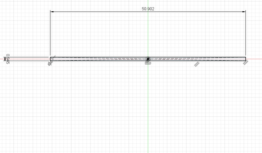

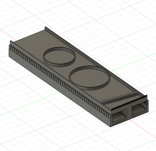

Step 8: Deciding a Scale Factor for the 3D Model
The first thing is to figure out the scale factor you want. I chose the factor of 1,000 because my Fusion 360 is calibrated to millimeters. If you calibrated Fusion 360 for millimeters as well make sure to convert all your numbers to millimeters as well otherwise the scaling will not work. You don't have to scale it if you don't want to print it.

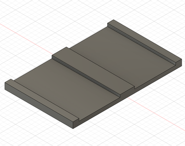

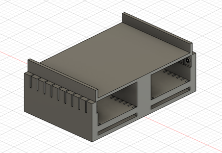

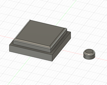

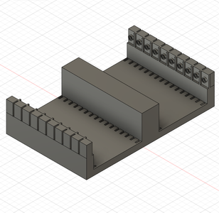

Step 10: Making the Base for Mock-up (optional)
Decide what the center or the core of the bridge will look like, I chose hexagons because they are one of the strongest shapes, and since this bridge will carry quite a lot I wanted to make the pillars really strong. To start the base make a centered rectangle sketch tool to create a rectangle with the scaled dimensions of the flat part of your bridge and the height mine was 31ft(9.45). With scaling my dimensions were 0.9448mm and 59.16mm. Then, use the line tool to attach a line to the bottom corner of the rectangle and set the degree to 160, and make the line scaled to your trapezoid leg. Then create a line that is 0.1524mm higher than the first make the line as long as the first and connect the two lines. Finally, extrude all the lines to the scaled width of your road my value was 2.5603mm I added 4ft(1.22m) to the length of the road to account for the wall of the tunnel.

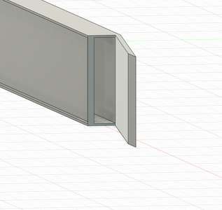

Step 11: Creating the Tunnel/Barrier (Optional)
First, make a sketch on the side of the rectangular prism and make a center rectangle with the dimensions of the tunnel. Remember to use the dimensions of the tunnel and not the whole bridge. For example, the height of my bridge was 31ft (9.45m) tall but the tunnel height was 20ft (6.1m) tall. The width of the whole tunnel was 84ft(25.6m) wide but the place where the cars are is 80ft(24.38m) so make sure to use that dimension. Before you use any dimensions make sure it is converted into millimeters and scaled to the desired size.
Step 12: Finishing Details for the Base. a (Optional)
The first is to level out the ramps so it accurately represents a ramp on a road. Make a sketch on the x and y plane and create two right triangles right under the ramps to level it out to the base of the rectangular prism. The hypotenuse should be along the edge of the ramp. Then, extrude the triangles to the length of the road. Next to make the indent on the top of the bridge for plants dirt and play structures make a sketch and create a center rectangle with each dimension the same as the rectangular prism but each side should be 4 feet (1.22m) less on either side (make sure to scale before making the bridge and convert). Next, center the rectangle and cut into the rectangular prism the equivalent of 4ft(1.22m) when scaled and converted. Lastly, for the pedestrian part of the bridge pick a few spots to add sidewalks going across to the other side of the road. The way you do this is to create rectangles and extrude them so they are flush with the top. I was not too concerned about the placement of these sidewalks just make sure that there are six open spots.
Step 13: Finishing Details for the Base. B (Optional)
For this part choose two slots for playgrounds plus a small one for a playground extension, one for soccer goals, and one for a picnic area. For the playgrounds make a couple of circles for the main structure and offset them to the equivalent of one foot (0.3m) this will become the barrier between the grass and loose material for the fall zone. For the soccer goals (these will be simplified because my scaled figure is already quite small) make two small rectangular prisms. The dimensions for average soccer goals are 16ft(4.88m) wide and 7ft(2.13m) tall I made them the equivalent of 5ft(1.52m) long. When making the picnic area create a circle in the center for the main area and two smaller areas on the side (any shape you want) for small tables. Finally, add the equivalent of a 6ft(1.83m) fence along the sides that meet the highway (this would be just a rectangular prism). make sure it covers the entire width of the bridge and it does not cover the long side of the bridge because it would inhibit the use of the sidewalks.

Every measurement in the next steps should be scaled and converted. Since each measurement will be scaled by a factor of 1,000 the meter conversion just needs to be switched to millimeters. For example, if a component is 1 meter long the converted and scaled version would be 1 millimeter.

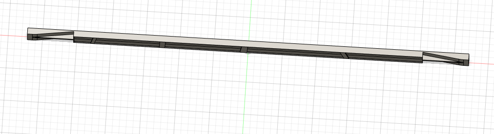

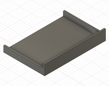

Step 16: Splitting the Bridge/tunnel Into Parts (Optional)
For printing the bridge is too long to print in one big piece so it is important to split the bridge up. This will also allow for finer details and less repeating details. The parts and dimensions for each piece are listed below:
  1. The ramps: these will only need to be created once because it is duplicated on the other side. The ramp piece consists of the full ramp and 17.22mm of the bridge to make the connection between the ramp and tunnel as seamless as possible.
  2. The three bridge pieces:
  3. Two identical bridge pieces that are 96.44mm long.
  4. A third piece that will be the longest piece at 160.57mm long.
The third piece is a different size than both the other pieces because on either side of the piece is a drainage ditch leading into pipes that feed into Boulder Creek.

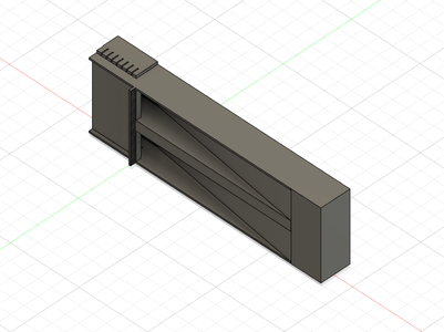

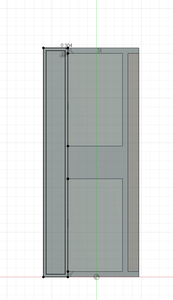

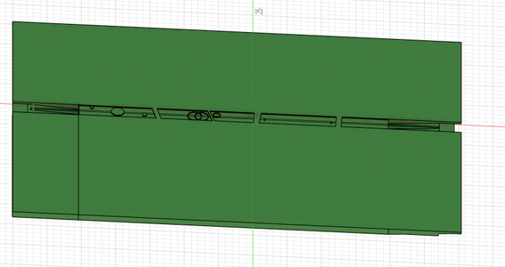

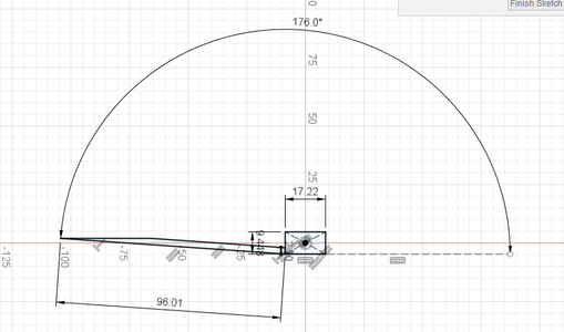

Step 17: Ramps of the Bridge: Part 1
The first thing is to create a rectangular prism that is scaled and converted size of the first section of the bridge. Then extrude the bridge to the scaled and converted width that works for the road. Remember to make it a pretty tight fit but leave room for the places where the car exhaust will be removed this will be about 4ft (1.2m). For example, my road was 80ft (24.4m) wide but I wanted the walls of the tunnel to be 2ft (0.61m) wide so I extruded the bridge to the equivalent of 84ft (25.6m) which was 25.6mm in fusion 360.

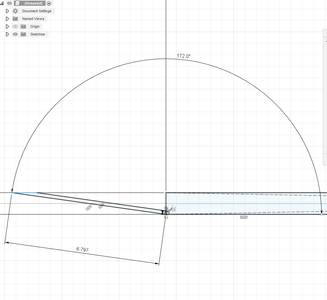

Step 18: Ramps of the Bridge: Part 2
The first thing to do is create a right triangle that is on the same line as the rectangular prism and extrude it so it is flush with the tunnel (a tip for extruding is if you click on the face you want it to extrude to you don't need to put in a measurement, and if that isn't possible then you can use the measuring to tool to get the dimensions you used this also works with a circles diameter). Make a sketch on the end of the tunnel and create two large rectangles 10.365mm by 5.206mm and two small rectangles with dimensions 1.22mm by 10.365mm. Then add the sketch restraints of 1.828mm to the roof of the tunnel then add restrains of 0.609mm to the sides for the large rectangles. The smaller rectangles need lightly different restraints, add a restraint to the bottom of the road with dimensions 1.219mm then add a restraint to the walls of 0.609mm. Finally, extrude all the rectangles to create the tunnels and drainage.
On the top make a large rectangle of 24.384mm by 16.611mm with a sketch restraint of 0.609mm on either side (for the other pieces still use the 24.384mm but make the length as long as the piece that is being made). This should leave one side without a curb.
For the rest of the pieces of the bridge/tunnel repeat the process that was done on the rectangular piece but with the dimensions for the largest rectangular prism listed below:
  1. Duplicate pieces - 10.363mm by 96.44mm
  2. Largest piece - 10.363 by 160.57mm

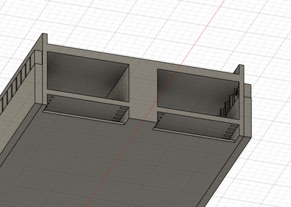

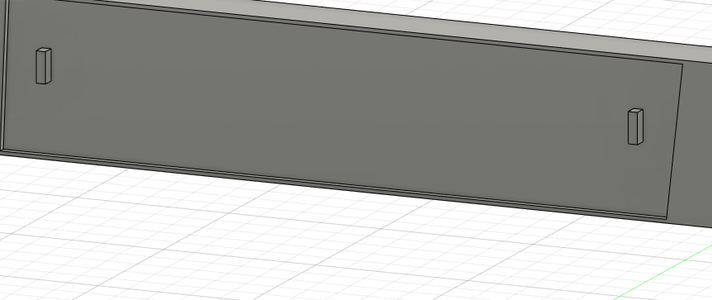

Step 19: Detailing the Ramp Piece

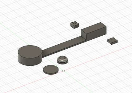

The road needs a place for the drainage grates so in order to make that create a sketch on the road and create a small rectangle 0.914mm by 0.305mm completely flush with the wall and a restraint of 0.39mm to the edge. Then, extrude the rectangle to make it into a hole. Next, create a rectangular pattern repeating 20 times all the way to the end of the rectangular prism. Then in the drainage ramp area make a quadrilateral starting 3/4 up the side of the median and ending halfway down the median (this should not be made in the tunnel but under it in the drainage area). After that extrude the quadrilateral on either side to create the ramp.
For the CO2 filters and backup fans make a small rectangle 1.524mm by 2.452mm on the outside of the tunnel with a sketch restraint to the top with dimensions 0.902mm and one to the side of the tunnel with dimensions 0.155mm. Make an identical one on the inside and inset the rectangle by 0.305mm and extrude the outer rectangle by 0.938mm. Directly underneath the boxes make a large rectangle stretching the length of the tunnel piece and going all the way to the bottom of the drainage ditch and extrude it to be flush with the box (make sure the extrude tool is set to new body). For the fan portion center a circle in the rectangle with a diameter of 0.909mm and three other circles inside that one with diameters of 0.709mm, 0.506mm, 0.306mm. Extrude every other circle to the edge of the tunnel wall like a target. Finally, use the rectangular pattern tool to repeat the box and fan part 10 times all the way to the edge of the tunnel.
Repeat this on all the other pieces' dimensions for those are listed below:
Duplicate piece - Drainage grates repeat the pattern 130 times and the boxes 65 times till the end of the tunnel.
The longest piece - Drainage grates repeat the pattern 190 times and the boxes 90 times until the end of the tunnel.

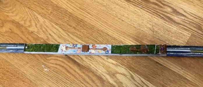

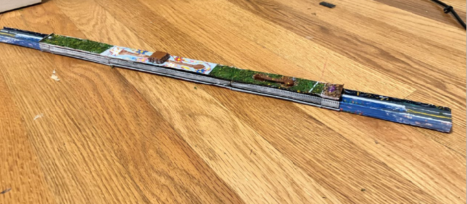

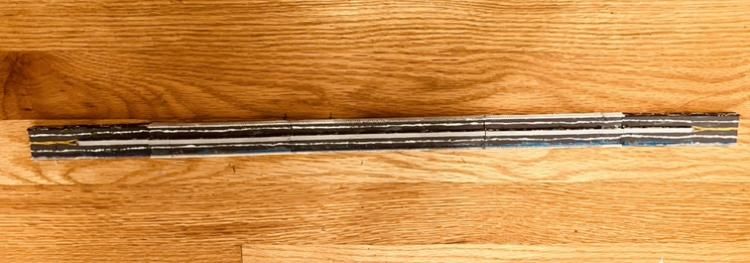

Step 21: Optional Step Printing
In order to print it split each piece into three parts:
1) the top where the people will be walking.
2) the tunnels and the road.
3) The ramped drainage system.
The ramp needs to be printed differently because the ramp piece has to be separated from the rectangular piece attached to it. Otherwise, the ramp does not need to be printed in pieces like the other parts. The reason why the ramp was made with a small part of the bridge was to ensure that the ramp into the tunnel and the bridge lined up perfectly.

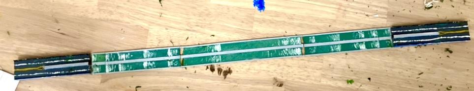

Step 22: Painting the Road/tunnel
For the road, I painted it a dark ash fault color because in Colorado it snows a lot and sometimes it can get pretty bad so most of the roads are darker in color to let the snow melt as fast as possible so it doesn't get to dangerous. So, make sure when painting the road paint it the color of the roads in your area. For example, Florida's roads should be painted a sandy color because they are made out of sea shells and other light-colored things as to make the roads less hot. Highway 36 is a four-lane highway the median is the wall in the middle so the lines going down the center of each side of the road should be white solid lines to show that you can't pass and you are not going into oncoming traffic. Next is to paint the scenes in the tunnel. For the underwater scene (mentioned in the solutions step) I used dark blue, white, red, yellow, purple, and green. First, create a sky on the wall of the ramp by mixing white and blue, it is okay if it is not mixed fully because it will add more depth just make sure the sky is light. Next, add in clouds (no cloud is the same) and make them lots of different shapes I tend to go for long wispy ones. In the real sky, it is never just blue there are oranges, pinks, and yellows same with the oceans, but because this is such a small-scale piece I opted for just blue to make sure the other colors didn't look like something else. After adding in the sky mix a darker blue by adding less white paint (black paint should rarely be used to darken because it is so strong) and start the ocean halfway down the ramp adding a white foam-type texture in between by tapping the brush. Once that is finished take all your warm colors excluding purple and make coral and seaweed (these plants are very squiggly so they don't have to be exact shapes) over top of the coral and seaweed add some tiny purple fish swimming anyway. Finally, add in the coral dragons using bright colors. The mural in the tunnel should be bright and welcoming because tunnels can feel claustrophobic so adding lights and scenery it will take away that feel.
On the other side of the tunnel where the outgoing traffic is coming from use blue and black to paint the whole thing a dark blue. Repeat the same steps for some clouds and finally add in some sand figures with bright yellow paint. Paint their dust trails first then a small yellow figure at the end. To finish the tunnel off paint the outside light grey and the inside machinery the same color. Then, dry brush everything in an even lighter grey or wight (dry brushing is when you get color on your brush and get as much of the pain off as possible then brush it over the raised edges) this brings out all the detail in the model.
Step 23: Painting the Drainage Ramp
To paint the drainage ramp first you need to mix up green and blue with mostly blue in the mix to create the color of sewer water. Then paint the whole thing in that color and as the last coat of paint is still drying use white and dab it right under the shelved area. Finally, paint the sides a light grey.
Step 24: Painting the Bridge Area
For this part paint anything that needs to be grass green. It doesn't matter if it is an even coat because it will be covered later the green paint is just to cover anything that might show. Then paint the playground area brown along with the non - greenhouse garden area. This paint job also does not have to be perfect for the same reason. Next, paint the concrete areas a light grey and the gazebo brown and detail it with brown stripes. For the raised details use a pair of scissors to cut up a green piece of paper or face moss a bunch of times until it is very fine (this is called flocking) and hot glue it to the grassy areas. Do the same thing but with brown cardboard for the garden and playground to simulate the loose padding. Finally, glue all the little 3D printed pieces like the play structure onto the model. Paint the play structure and gazebo brown with yellow highlights and the greenhouse grey and glue colorful flocking onto the community garden. Paint the area around the gazebo grey then add lots of colors but mostly blue to make a river liker thing going around the gazebo along with giant flowers in any color that is desired. For the little creatures/monsters floating down the river paint colorful blobs.
Step 25: Glueing the Pieces Together (final Step!)
Finally, glue all the different layers together with hot glue and glue the ramp to the drainage layer. I kept mine separate so I could take the layers apart to see each component. If the gluing process leaves seams that is good because in Colorado it can snow and when it melts and then freezes again it could cause cracks in the bridge so putting joints in the bridge so it flexes with the ice is ideal.
