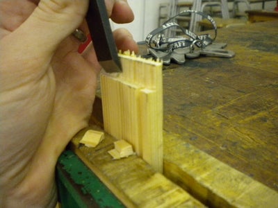

Step 6: Cutting the Lap Joint
Tools; Chisel / Mallet / Plane / Flat File / Wood Vice
This introduces two new tools and requires the students to use them accurately. Put one of the sides in a wood vice and draw a line centred across the top of the work piece. Carefully position the chisel on the line with the bevelled edge facing you. Now tap lightly with a mallet, then move the chisel across and remove the next bit until the rebate is totally exposed.
Repeat the process so the other side is also chiselled out, use a flat file to remove any small bumps left on the wood....remember to keep it level!

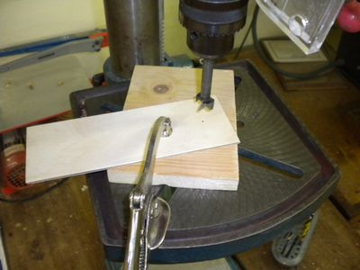

Step 16: Drilling a Hole in the Lid
Tools; Forster bit
Machines; Pillar Drill
The lid needs a hole for opening, using a pillar drill and a forstner bit (you can also use a hole saw or flat bit) Measure and mark the hole position, I go for the centre and 30mm in from the edge. You must have a solid piece of wood underneath the lid to prevent splitting and of course drilling the machine table. H&S rules say that all work on a pillar drill must be secured in a clamp, vice of hand vice...please follow these rules.
