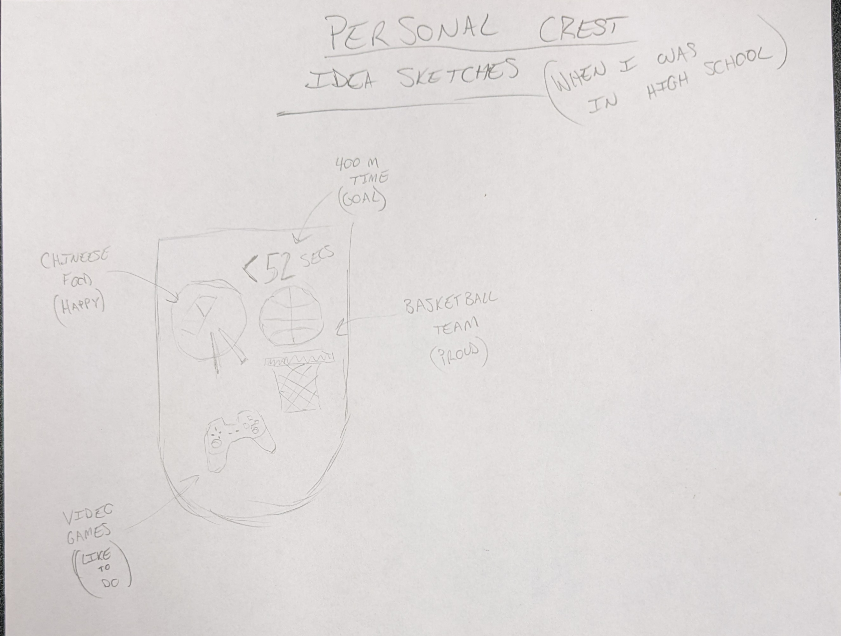

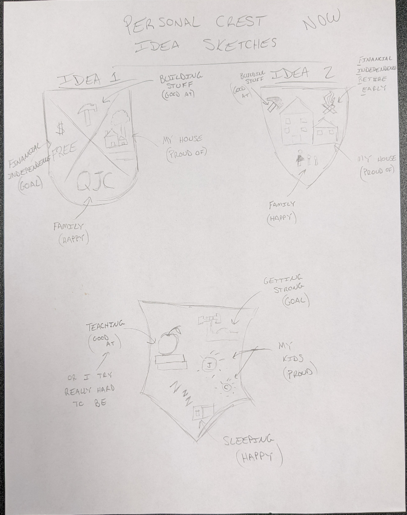

Before I let my students start working with CAD on their design, I have them create three concept sketches of their personal crest ideas.
This is the first classwork I have my students complete. The students walk in on day one, the bell rings, I introduce myself, get the kids in the right seats, I go over the emergency procedures, and then we start this activity.
I don't teach any lessons or skills about sketching or CAD beforehand. Many of my students have taken an engineering class at our Jr. High. At some point in the last two to three years I know they have been taught basic sketching skills. I use this portion of the project as a semi pre-test to gauge their sketching skills.
The sketches don't have to be amazing, but I don't them to by just bad stick figures either. I require the sketches to be annotated. Students need to label the components of their crest and what those parts represent about themselves.
At this point I show my students examples of what I'm wanting them to create by showing them my own sketches. This accomplishes two things. First, It shows the students the basic quality of sketch I want and the format their sketches should be in. Second, it allows the students to get to know me ,their teacher, a little better.
The design for my crest would look have looked completely different when I was in high school. So after showing them what my current ideas area I show them a sketch of an idea I think that my high school personal crest would have looked like when I was a freshman or sophomore.
This usually starts a pretty fun conversation in class. This also lets the students know that their ideas don't have to be super deep, soul exposing thoughts that they have to represent in their design. If they put on their design that their goal is to get a 100% completion on a video game, that's AWESOME! When I was in high school (and probably a few of my college years) that is type of thing I spent my time on too.
When they have completed their sketches I have them show me their work. They give me the overview of their designs and which one they like best. This is a great one on one interaction where I can ask for the backstory behind what they put down on paper. Generally, the design the student likes best is the one I let them do for this activity. As long as its all school appropriate, it's good to go.
I've had my students use standard blank copy paper for this step, but I created a simple handout that I plan to implement the next time I use this in class. The handout just has the information on the criteria, what the students are needing to do and then dedicated spots for them to brainstorm ideas for each of the four areas they need to incorporate into their design. On the back of the paper I'll have them create their sketches. The document is linked/attached below.

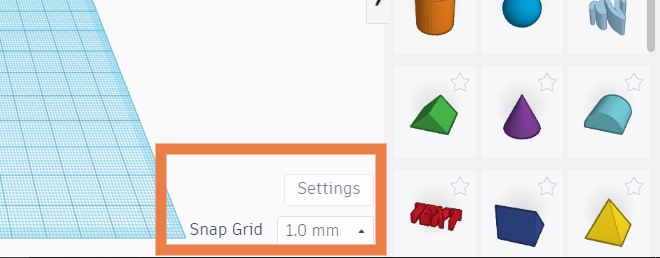

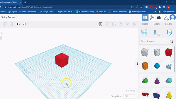

Workspace Setup

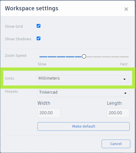

Before starting the design I always have my students change their workspace settings. These setting are shown and can be changed in the bottom right hand corner of the workspace area.
I have my students turn off "Snap Grid" as it usually causes more problems than it solves. That can be accomplished simply by clicking the dropdown menu for the "Snap Grid" and selecting "Off".
I then have my students change their units to "Inches" instead of millimeters. Being in the United States most of my students have very little regular exposure to the metric system.

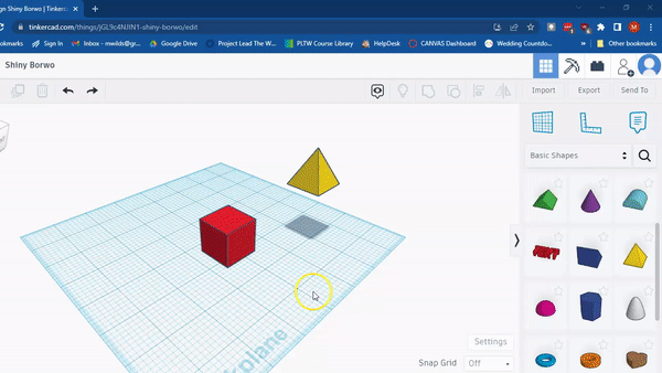

Align Objects
Being able to position the objects in a quick and accurate way is incredibly helpful. Using the Align tool is the best way I've used to complete that process most of the time. The Align tool can be found in what I always refer to as the "Object Tools" section, which is in the top right corner of the Workspace area.
The GIF below shows the quick process of how to use this tool. The basic steps of the operation are:
1) Select the objects you want to position together.
2) Select the Align tool.
3) Click on the position dots to align the objects in the orientation and position you need.

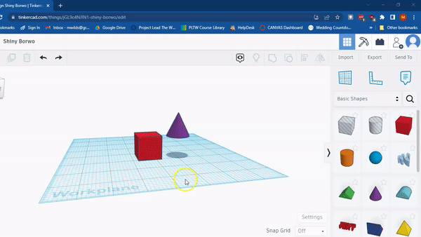

Grouping Objects Together
Grouping shapes together is also another very helpful process. I show my students how to use do this in a similar fashion to what is displayed in the GIF below. The Group and Ungroup tools can be found in the "Object Tools" section, in the same area the Align tool is located. The basic steps are:
1) Select all of the objects you want to group together.
2). Click on the "Group" or "Ungroup" tool.
The big tip I give is to make sure the objects are touching an in the position you need before grouping them together.
This is a really powerful tool when used with the Align tool.

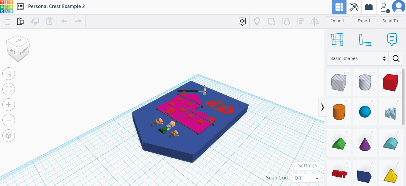

When all is said and done I tell my students their 3D model should look something like what is shown below.
After designing a few examples for my classes I realized that 1/4" thickness could probably work just as well as the 3/8" criteria I set for the project. I did have some issues when trying to edit some of the premade Tinkercad objects to work with a 1/4" thickness, but if you are looking to be more material efficient when 3D printing I think 1/4" could work fine.

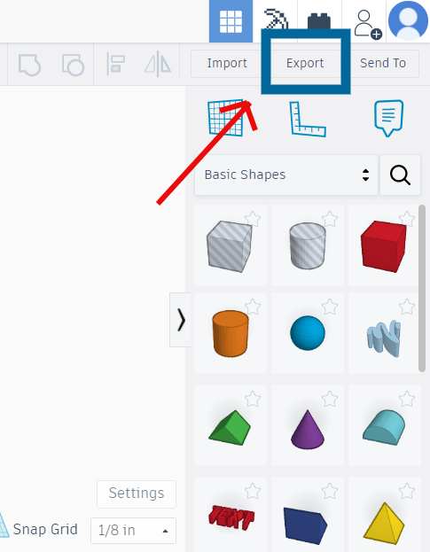

To export for 3D printing in Tinkercad you can select the "Export" button on the top right corner of your screen, located above the shapes menu.
Once you select the export option the export menu will pop up on your screen. Select whichever file format you need to run on your printer. We use the STL file. After selecting the file format you need the model will begin exporting to your computer.
I show my students how to do this process. Then they either share their file with me through Google Drive or I have them save it directly to one of our classroom flash drives.

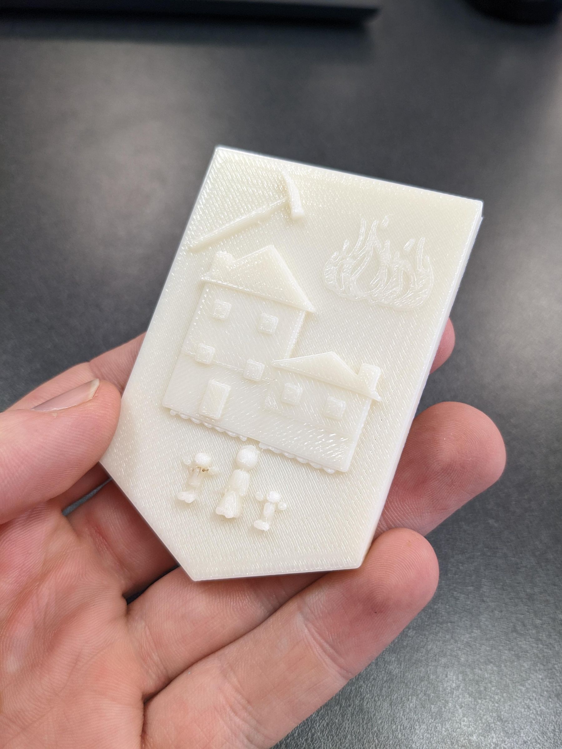

When I have four to six student designs ready, I start running them on our 3D printers. I give a quick overview of what 3D printing is, how it works, and the process used to run our printers. I don't have the students set up the printer on their own for this project just to save time.
With a class of 20 or so students and two 3D printers it usually takes around two days to finish all of the printing.

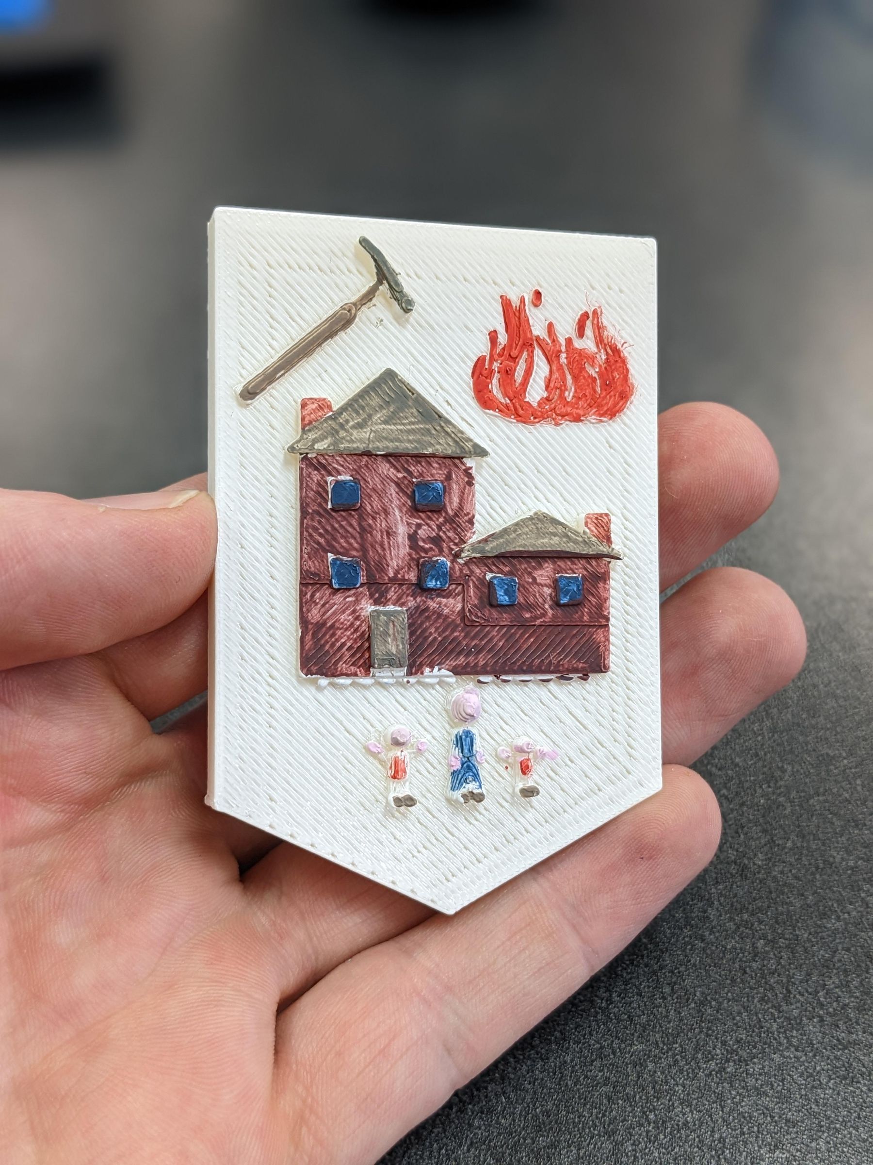

After all is said and done they come out looking like this.
If there is time, and if the students want to, I let them take the time to paint their crests for additional flare.
