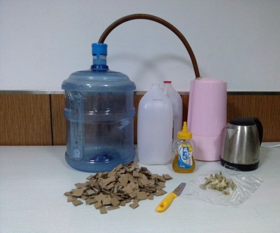

Step 1: Construction of Device
Used electronics:
- A used ultra sound air humidifier we wanted to throw away (costs for new product: 69 Yuan RMB)
Other things used:
- A water tank from a water dispenser (Deposit costs of around 50 Yuan RMB)
- Small hose
- An old analog thermometer/ hygrometer (costs for new product: 19 Yuan RMB)
- Hot glue
- Tape
- File
- Saw
- Kitchen Knife
- Grinding paper
For the growing:
- A 4l plastic bottle as bowl
- Cardboard as substrate
- Honey to add some more nutrients to the substrate
- 1 - 2 Oyster mushrooms for “cloning” the mycelium
- Boiling hot water for pasteurizing the substrate
- Sterilized water for using in the air humidifier

Cut open the water tank by using the saw (We tried using a kitchen knife, but the tank is to stable for it). The water tank we used had a wider section right at the opening, where we sawed it, so that we can use the smaller part as a lid for later. After the sawing we smoothened the edges by using the file and grinding paper.
Step 3: Step 1.2:
Attach the hose to the opening of the water tank and seal it by using hot glue and tape. The other side of the hose is attached to the removable lid of the air humidifier and also sealed.
Step 4: Step 1.3:
Glue the thermometer/ hygrometer to the tank’s wall from the inside. It should be readable from the outside, even when there is a lot of moisture.
Step 5: Step 1.4:
Put the two parts of the water tank together. If they do not close so well, help yourself by adding some tape/ hot glue on the edges or grind material away with grinding paper. It doesn’t need to be 100% sealed, but the majority of the moisture should stay inside. We do not fix the lid in its final position before we put the self-made plastic bowl into it. (See steps at farming). If the plastic bowl is prepared and inside the tank, we attach the lid with some tape.
