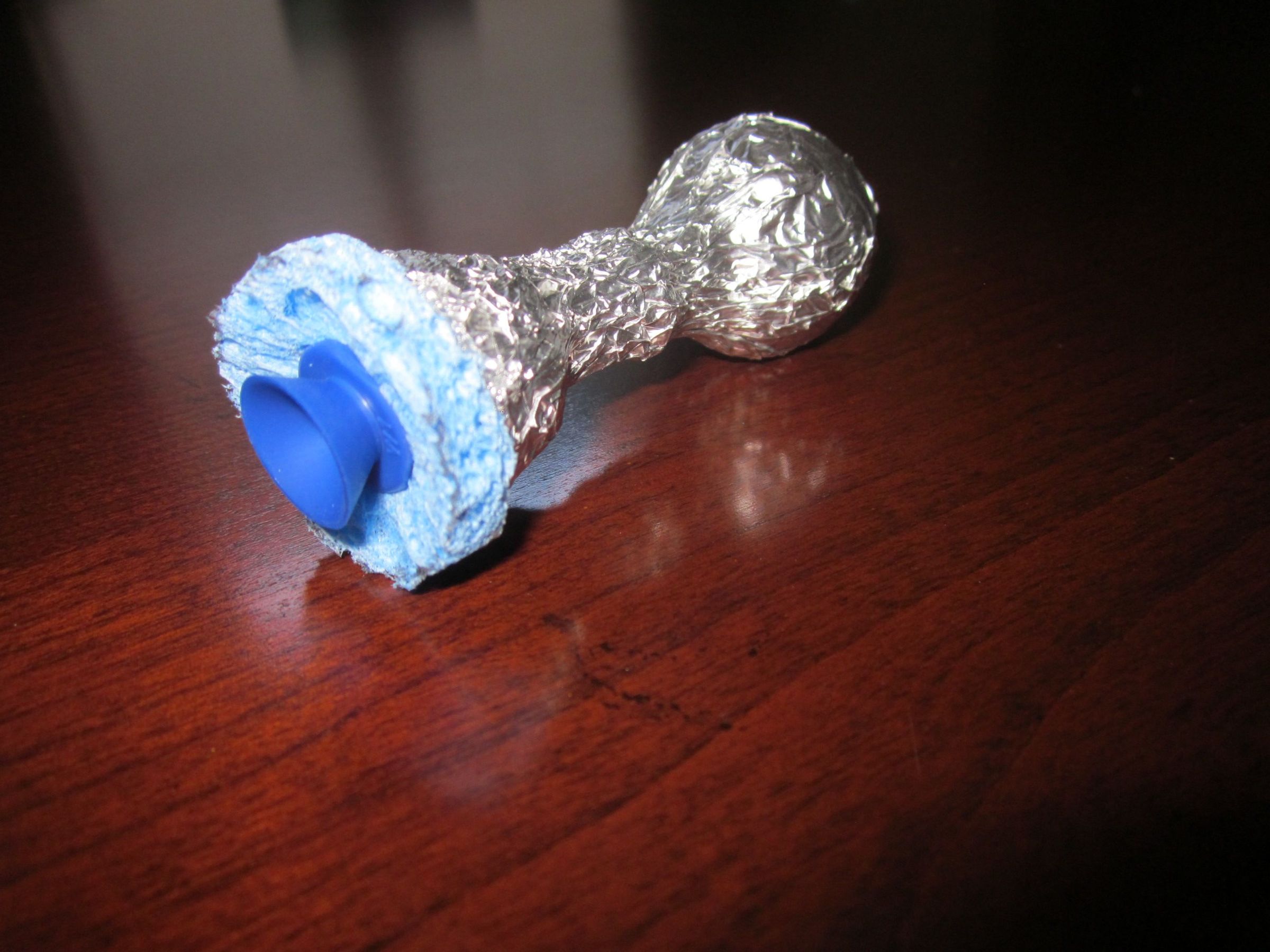

Now take out a small piece of Play-Doh and wrap it around one of the clips. Try and completely surround the alligator clip. Leave a small ball of Play-Doh at the base. This is what will attach to the screen so try and make it about the same size as the tip of your finger. The shape of the Play-Doh should resemble a headphone earbud.
Step 5: Put on the Button
Now add the piece you will use as a button. I used a penny but anything that is conductive will work. This includes Play-Doh, tin foil, and many foods like fruits and vegetables. Attach your button to the other clip you did not put the Play-Doh on. Try and have as much of the clip touching the button as possible.
Step 6: Connect It

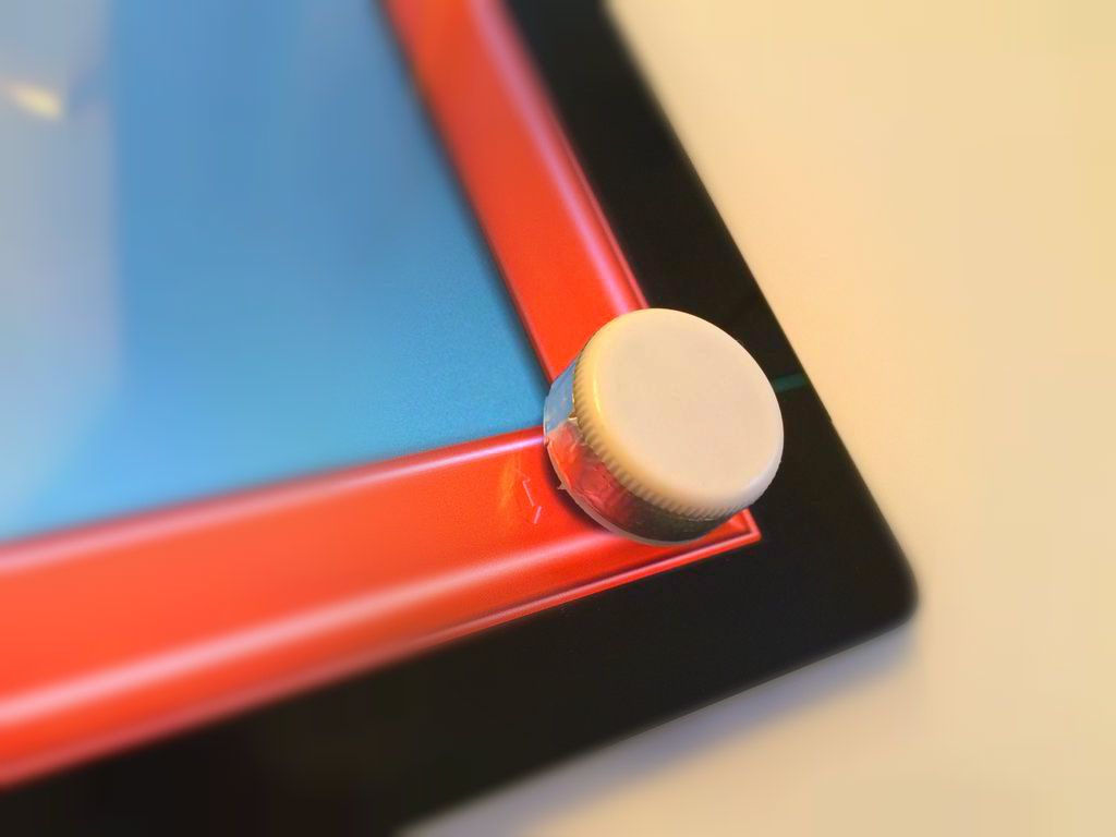

You are done with your awesome controller! Now just lightly push the Play-Doh onto the screen. When you press the button it should act just like you are touching the screen. Make sure that the Play-Doh touching the screen is about the same size as your finger.
