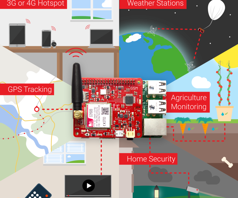

IOT BIT 4G & LTE Hat for the Raspberry Pi
4G (100 mbps down/ 50 mbps up) – Ultra fast internet connectivity for your raspberry pi, excellent for large downloads and video streaming.
TheIOT BIT 4G & LTE Hat for the Raspberry Pi Beta provides 4G mobile data for the Raspberry Pi mini computer. Our intelligent HAT module provides your Raspberry Pi with mobile data, GPS positioning information and battery support. This is the perfect module for hackers, scientists, and creators as it gives your Pi powerful connectivity wherever you are. Simple plug out module into your Raspberry Pi and start playing.
Find out more & order at https://altitude.tech/shop
The HAT can integrate easily with the software on your operating system giving you access to general internet data through the mobile network. Using our API this hat gives you the ability to send SMS (text) messages. We also give easy access to the GPS onboard which exposes location data.
HAT Features
  • Supports any nano sim. Slot your sim card in and get going
  • 4G Mobile Data for the Raspberry Pi
  • Easy set-up, with a single terminal command setup our software to streamline Pi Anywhere with your Raspberry Pi.
  • Wake up your Pi or trigger events with text messages.
  • Optional external antenna for better reception.
  • High-efficiency power regulation up to 3 amps.
  • Use for external projects with a solar panel and battery pack.
  • It can be used in conjunction with our Sensly gas monitoring HAT
