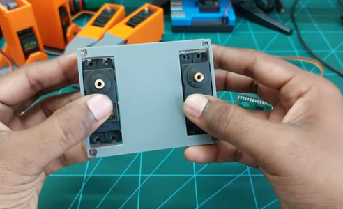

Step 3: Assembling the Body
Similarly assemble the servos to the main body in the same manner as earlier. Make sure to tighten the servo to the 3D printed parts properly.

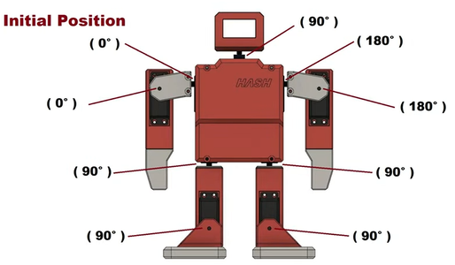

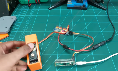

Step 5: Servo Initial Position
Set the initial servo positions of the robot according to the diagram.
You can use the following circuit to set the servo angles each time.

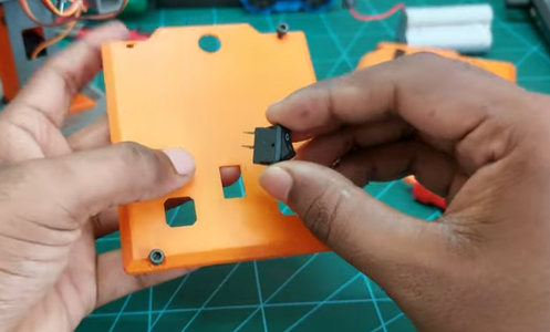

Step 10: Connect the Switch and the Buck Converted Module
Add a switch at the back of the robot and connect a buck converted to the power input pin. Make sure the set the voltage to 5V.
