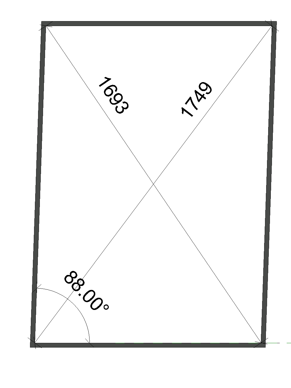

Is the corner 90°?
How important is this? That's questionable but different projects require different levels of accuracy. So we use a square or similar for most checks. But what if the item is bigger like a kitchen cupboard or a gate. 0.5mm out on your 200mm square can equate to 10mm at the other end of the work piece.

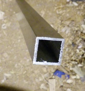

Aluminium square tube (25mm, 20 internal)

The basics are:
  • 2 sticks - fixed together in some form when required, but can be lengthened or shortened as required.
  • To allow measurement between 2 internal surfaces
  • To allow measurement between 2 opposite corners to compare.
If two opposite sides are the same length then the measurement between diagonals will be the same. If the corner is off from 90deg then the measurements will change.

Step 3: Aluminium Tubing
The square tube was cut to 60mm and filed smooth. A hole was marked, drilled and a thread cut to accept a wing bolt.
The rectangular tube - being scrap, was just cleaned up and the plastic inserts were removed from one end. I ended up with 3 pieces 850mm long.

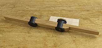

Step 7: Additional Design Element
So the current alloy tube length means I can't measure anything below apx.900mm. if I had more tube I'd cut shorter lengths to deal with this but I don't and I'm not going to cut what I have.
If I use the pinch brackets as they are I can create shorter wooden 'sticks', but I'll design this specifically for measurement transfer.
Two strips of wood 9.5x19.5 were cut, apx 400mm long.
One end was cut to allow the depth of the bracket on one piece. The other piece had an extension glued to one end. A 30° angled cut was done to each piece.
The idea of this is to have an extendable tool with each end flat against the surface so when you transfer the measurement it's more accurate.
Very simple to make, uses the existing bracket and I can create a few different lengths.
