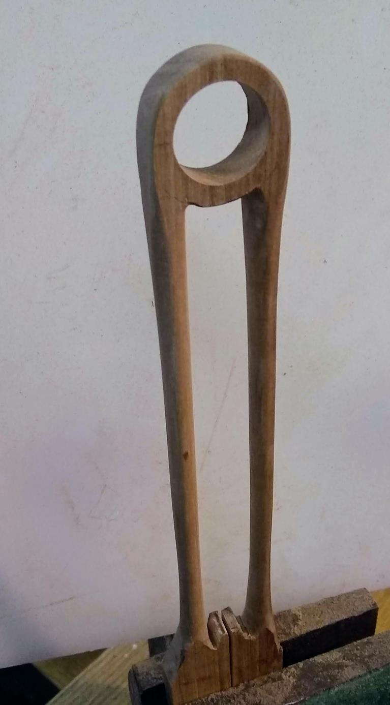

Step 2: Cutting the Form
So the 'log burner wood that never made it to the log burner' - walnut, had a lovely straight grain. I cut this to 10mm strips and sanded down to to smooth enough to draw on. The design was pencilled straight onto this then was drilled and cut to create the basic form.

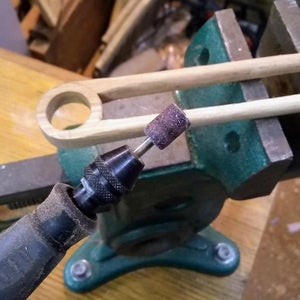

Step 3: Shaping Up Nicely!
Out came one of my most used tools - the Dremel Rotary Tool with a sanding bit. This did most of the dog work to achieve a rounded form for each prong. I then finished it off using strips of emery cloth in different sanding grades. You need to rotate the piece to make sure you get an even shape up the prong shaft.

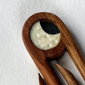

Step 4: The Decorative Disc!
I had decided on a moon and stars style decorative disc but was unsure of what to use to give the right effect. I tried wood plain, wood burnt, wood dyed, coconut shell, leather and black acrylic. The moon/star shape was to be made out of bone to create a contrast.
Yes - deer antler would be great but accessing that is not easy - or cheap. A basic dog bone sold for about £1.00 and its already processed as to not be messy when cutting it. (I have tried bones from butchers - I can't recommend it!)

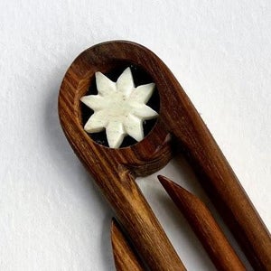

I decided the burnt wood was the best contrast with the bone set onto it.
I burnt the wood first, sanded down and burnt again and sanded again before cutting the disc. This created a harder smoother surface. These were glued into the prong head - standard pva is fine but epoxy glues work just as well.
The Moon and Star shape was drawn out and cut - including the moon 'craters'. Again the Dremel did most of the work to do the shaping. I polished them up with a dremel polishing disc/buffer as well. These were glued in with epoxy.
