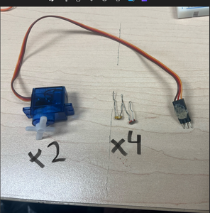

Servo Motors- 2 of them. $15 on Amazon
LDR- 4 of them. $10 on Amazon
Bread Board- 1 $17 on Amazon
Wires - $13 on Amazon
Arduino and cable- $37 on Amazon
Styrofoam/Pompoms/ any ball shaped item for the Planets

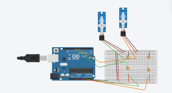

Step 1: Circuit Diagram
This is the circuit I made with Tinkercad Circuits and before building the actual project I tested the circuit with simulation.
This is a smart way to save your costs and time that might sometimes occur due to improper circuits, In my case, everything was tested with simulation with the circuit and codes, and then I started to build the actual project.
Make sure your power jumper wires are in the same area, as if it were anywhere else, it could potentially stop the power to the servo motor.
The Red wires mean power, and the black are ground. The jumper wire connecting the LDR allows the LDR's to be one entity, and attached to one pin, such as the A0 PIN and A1 pin. This code works as is:

I recommend you to replicate my circuit and play with different values so you will know the area of impact, After the simulations are complete we can head over to building the actual circuit.
Step 2: Building the Circuit
Since we already made connections in the prototype making the real connections should not be that hard.
Start by connecting the micro servo to the D9 pin of uno whereas the Gnd and Positive pins are connected to the breadboard power supply rails.
Now connect the LDR to the breadboard and connect one end of the LDR to the power supply and the other end to pin A0 also known as the analog pin of uno.
After this is done connect the power supply USB cable to any power source and connect with uno
If you are exposing the LDR to a light source the servo might move until the motion stops, Now you can place your finger on any LDR now you can see some movements in the servo.
Do that process twice to get two planets moving. If you want more, you can add another breadboard and add more. Add this code in the Arduino Program and test out your project!

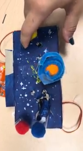

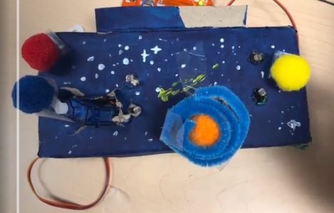

Step 3: Decoration
This is the decoration I made. Just a quick measurement of the breadboard, paint, and cut outs for the servo motors and the LDR's. Make sure your LDR's aren't blocked by the cardboard so they aren't interfered with and only interact with light.
