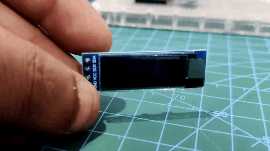

Step 1: SSD1306 OLED Screen
The 0.91-inch SSD1306 OLED Display is a compact and versatile screen commonly used in electronic projects and devices. Featuring OLED (Organic Light-Emitting Diode) technology, this display provides crisp and vibrant visuals with high contrast and wide viewing angles. The SSD1306 controller chip is employed to drive the display, enabling compatibility with various microcontrollers and single-board computers.
With a resolution typically around 128x32 pixels or 128x64 pixels, the 0.91-inch OLED display offers a small form factor suitable for applications where space is limited.
We're using a 128x32-pixel display in this project.
Its monochromatic display capability makes it energy-efficient, well-suited for battery-powered devices. The I2C communication protocol is commonly used for interfacing with the display, ensuring ease of integration into different projects.
These displays find applications in a wide range of DIY electronics, wearable gadgets, and prototyping projects, where real-time information or simple graphics are required in a compact form. The 0.91-inch SSD1306 OLED Display's versatility, small size, and energy efficiency make it a popular choice among hobbyists and developers for enhancing user interfaces in various electronic creations.

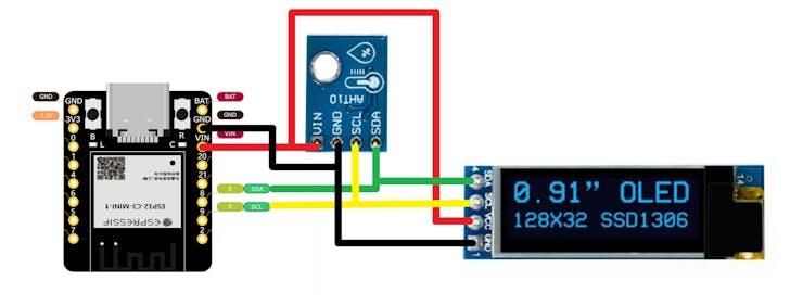

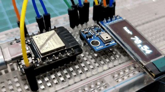

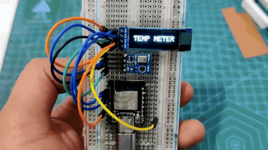

Step 3: Breadboard Setup

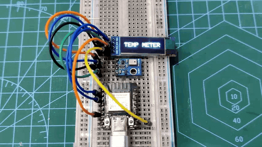

This is the breadboard setup, the first level of the project.
It is made up of the SSD1306 display and the ESP32C3 DEV board connected to an AHT10 temperature and humidity sensor on a breadboard with jumper wires.
  • We linked the VCC of the AHT10 Sensor, the SSD1306 Display, and the ESP32 DEV Board.
  • next, we connected GND of all three modules together
  • Finally, we linked the I2C pins of the AHT10 sensor, the display, and the ESP32 DEV board in parallel.
We loaded the attached code into the ESP32 DEV Board, and our setup is working and displaying TEMP data on the SSD1306 display.

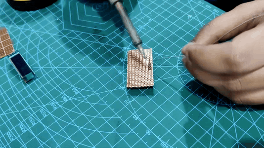

Step 4: LEVEL 2

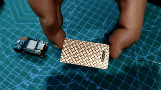

After completing Level 1 of this project, which was to make a simple running breadboard version, let's level up this project and make a proper circuit on a prototyping board.
Two 42 mm by 22 mm prototyping PCBs will be used for LEVEL 2, and all three modules will be soldered onto them.
The SSD1306 OLED screen will be placed in the center of the front PCB, while the ESP32 DEV Board and AHT10 Sensor will be mounted on the back PCB.
There will be a little LiPo cell placed between the front and rear PCBs.
Let's have a look at the assembly process.

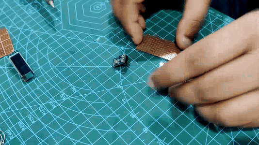

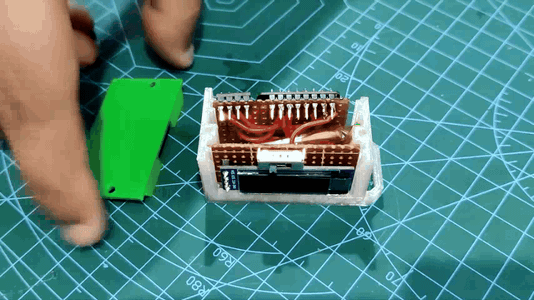

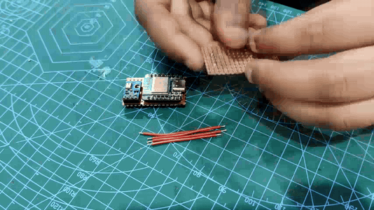

Step 5: CIRCUIT ASSEMBLY: ESP32 and AHT10 PCB
  • We begin by assembling the ESP32C3 DEV board and the AHT10 sensor onto the prototype board, then soldering their pads to securely connect them to the board.
  • Next, we connected both of their VCC pins together with GND and then the two I2C pins together as well.
In our case, the ESP32C3 Beetle DEV Board's SDA and SCL pins were GPIO8 and GPIO9.

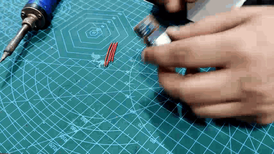

Step 6: CIRCUIT ASSEMBLY: SSD1306 Screen
After that, we put the SSD1306 screen in the middle and soldered its pins to secure it to the prototype board. That was all that was required to assemble the SSD1306 display circuit.

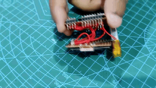

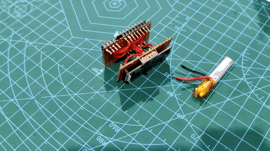

Step 7: CIRCUIT ASSEMBLY: Combining Both Circuits Together
The front PCB and the back PCB will now be connected by four more wires that we have added to the SSD1306 Display's terminals. These wires are VCC of the SSD1306 going to VCC of the ESP32, GND to GND, SCL to SCL, and SDA to SDA.
Step 8: RESULT SO FAR
Here's the result so far: the circuit is working, as you can see.
The AHT10 Sensor and ESP32C3 DEV Board, the project's main brain, are mounted on the back circuit. The SSD1306 OLED screen is located on the front circuit, and the I2C ports (SDA, SCL) and power lines (VCC and GND) connect the two boards.

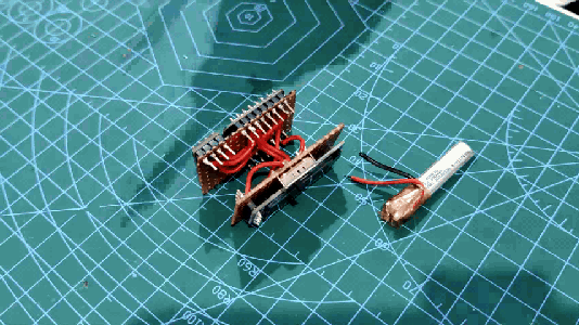

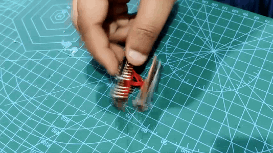

Step 10: Adding LiPo Cell to Circuit
We are using a little 3.7V 100mAh LiPo cell for portable power, and we have linked its positive terminals to the battery connector of the ESP32C3 Beetle Board. GND is connected to a sliding switch that we added to the front PCB later.
To turn this configuration on and off, a slide switch is linked between the ESP32 DEV board's GND and the battery's negative terminal.
The circuit has now been assembled.

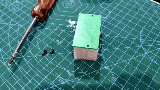

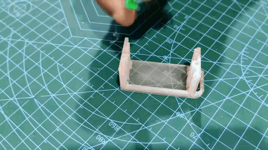

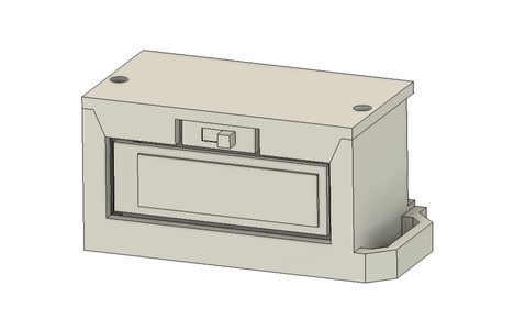

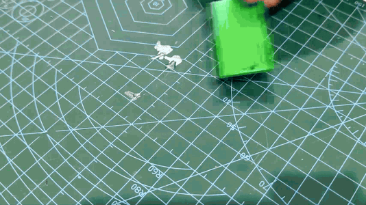

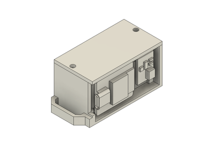

Step 11: 3D ENCLOSURE DESIGN
By first creating a model of the circuit in Fusion360 and then constructing an enclosure around it, we were able to create a basic enclosure for the circuit setup.
The plan was to create a two-part enclosure, the lower body of which would be used to slide both circuits (front and back). The ESP32 and AHT10 sensors are exposed on the rear, allowing us to reprogram the ESP32 and obtain accurate environmental readings from the back side.
The lid, which secures the circuit from above, was modeled next. Two M2 screw holes were created, which will be used to fasten the lid to the lower body.
Once the design was finished, we exported the two mesh files and used my ender 3 printer to 3D print them, using green PLA for the lid and transparent PLA for the base.

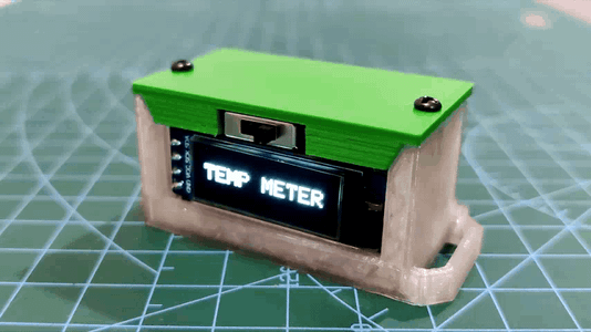

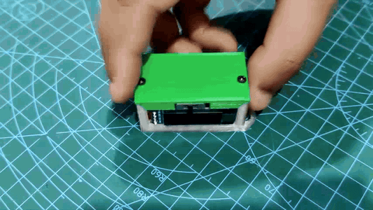

Step 12: ASSEMBLY
  • The final assembly process begins by first taking the lower body part and sliding the front circuit, battery, and back circuit in their place.
  • Next, we place the lid on top of the lower body and use two M2 screws to secure both of them permanently.

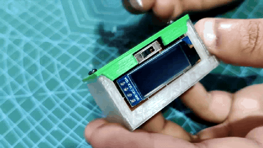

The pocket temperature and humidity meter is now ready.

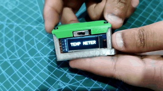

Step 13: RESULT
So here's the result of this simple build: a small, compact temperature and humidity meter made from scratch using a custom circuit and 3D-printed parts.
In the event that you want to collect temperature readings at different points in a row, the AHT10's accurate temperature readings are useful. The goal was to utilize this small meter, which is easy to take around and portable, to test the humidity and temperature of two different rooms at my place of work.
As for Level 3 of this project, I will be using a custom PCB in the next iteration of this project, so stay tuned for that.
