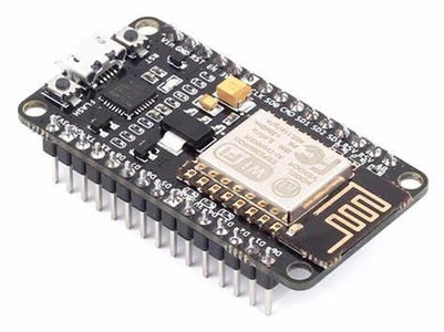

  • ESP8266, one can be found here

Connect the pins on your ESP8266 to the pins on the SD card reader as listed:
(ESP8266 -> SD card reader)
3v3 -> +3.3
GND -> GND
D2 -> CS
D7 -> MOSI
D5 -> SCK (or CLK/SCLK, it's called different things on different brands)
D6 -> MISO

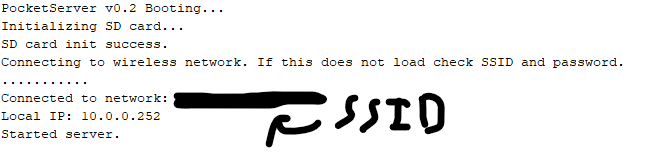

Once the sketch has uploaded, open the serial monitor (making sure it is on 9600 baud), and press the reset button on the ESP8266. If all has gone well, you should get to a point that looks like the image but instead of a black bar your wifi SSID is shown (I censored mine because it has a very goofy name lol). Then, try navigating to the IP displayed in your browser, making sure you are connected to the same wifi network. Don't worry, you'll be on the internet soon, but you gotta test first! If you have put an index.html file in the root of the SD card, you should be able to see the content stored in it shown. You can also try navigating to the paths of other files you added to the SD card.
Debugging for step 4: If the wifi does not connect, check the username and password. If the SD card fails, check your wiring. If you can't navigate to the local IP in your browser, make sure you are on the same network as the ESP8266.
