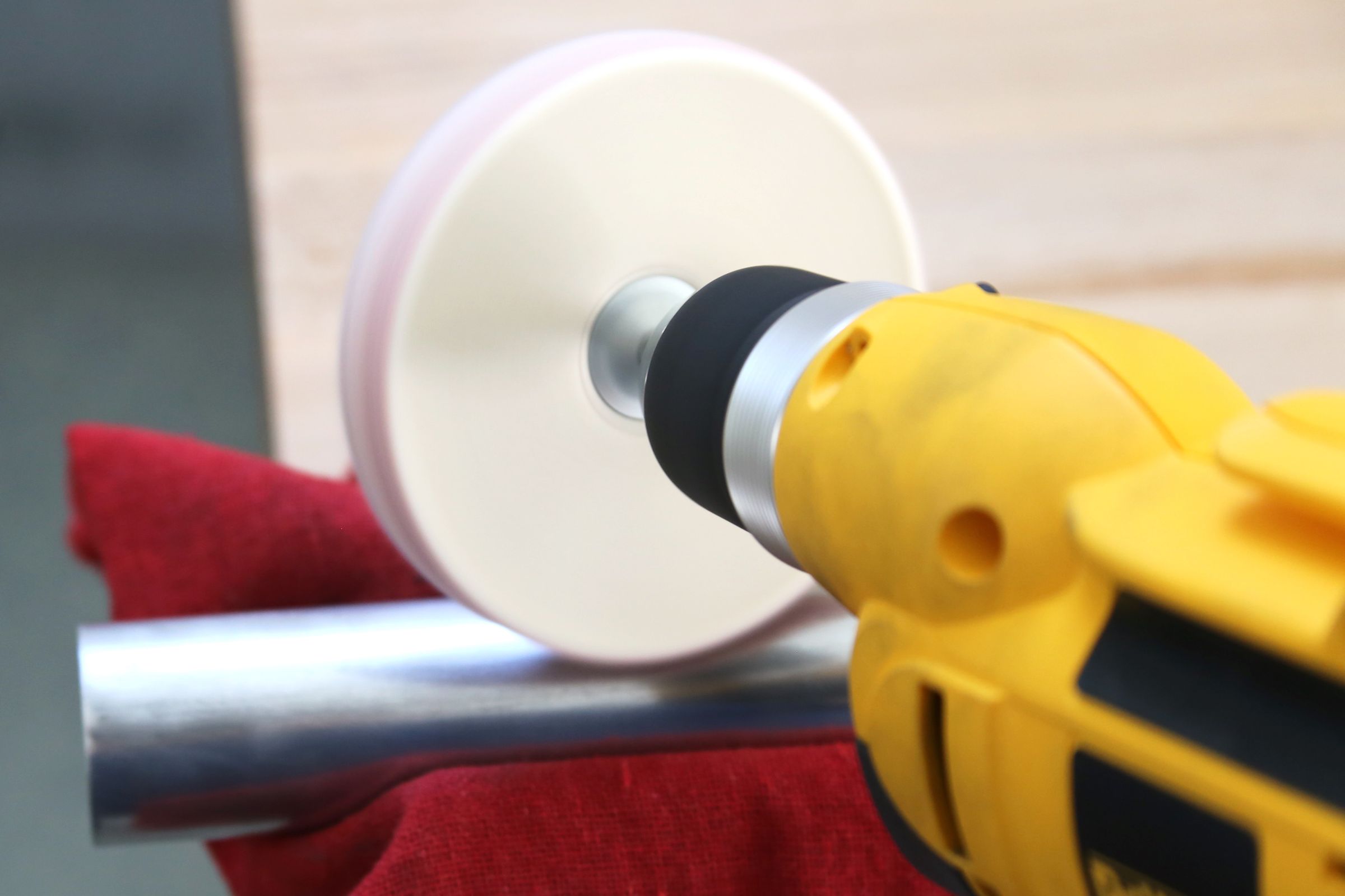

Step 5: Buffing Compound

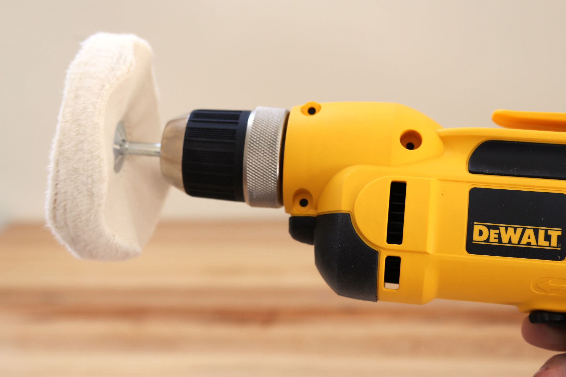

Insert the polishing wheel's shank into your drill bit chuck and spin it up to full speed.
Rub the spinning wheel along the green buffing compound until you have a nice coat upon the wheel.
Step 6: Polish
Clamp the aluminum into the vise, and while spinning at full speed, press the wheel down upon the surface of the tube.
Move it back and forth to polish it.
Resume doing this until the whole tube has been buffed and it has a nice shine.
Quickly wipe the tube down with your shop rag when done to remove leftover buffing compound. You don't need to do too great of a job right now because we are about to buff it again.

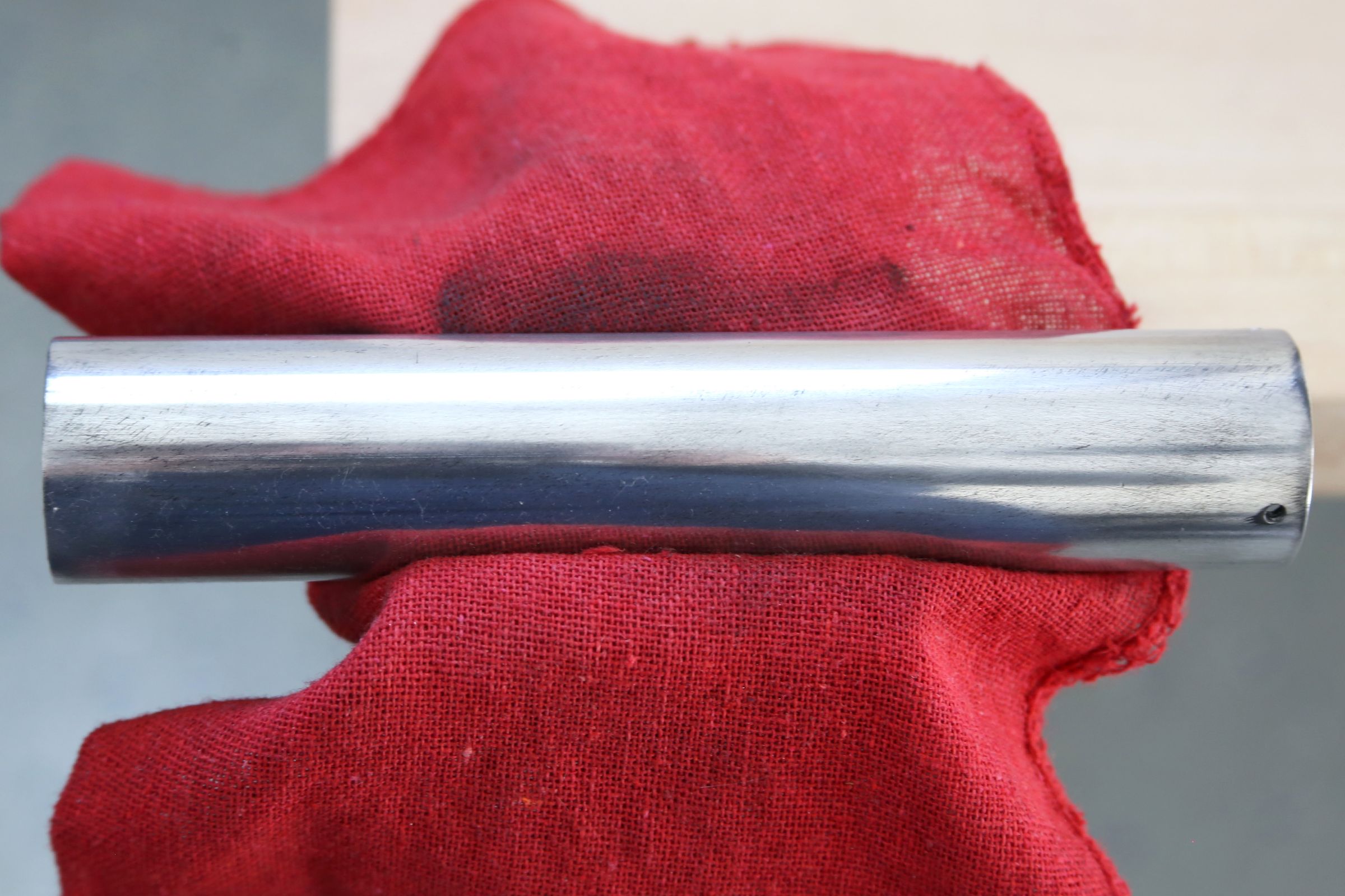

Step 7: Pink Compound
While the green buffing compound made things nice and shiny, it's really meant to remove shallow surface scratches and imperfections.
To really make it shine, you want to use the pink scratchless buffing compound.
This is applies to the tube in the same manner as the green buffing compound. Continue doing this until the outer body of the tube is polished.
Wipe it off when done. It should be fairly shiny.
If you want to get it really - really - shiny, it is better to use a real buffing wheel that spins with more torque at higher speeds. This shop tool really is able to polish the metal much more and really smooth it out. It also creates much more heat, which generally helps this process. That said, the drill mounted wheel will do for the purposes of learning.

Step 9: Dry It Off
When you come back, most of the gunk that was on the part will now be floating on the surface of the water.
Remove the part from the water and wipe it down with a microfiber cloth to dry it off and clean off any residual gunk.
Your tube will now be oh-so-shiny.
