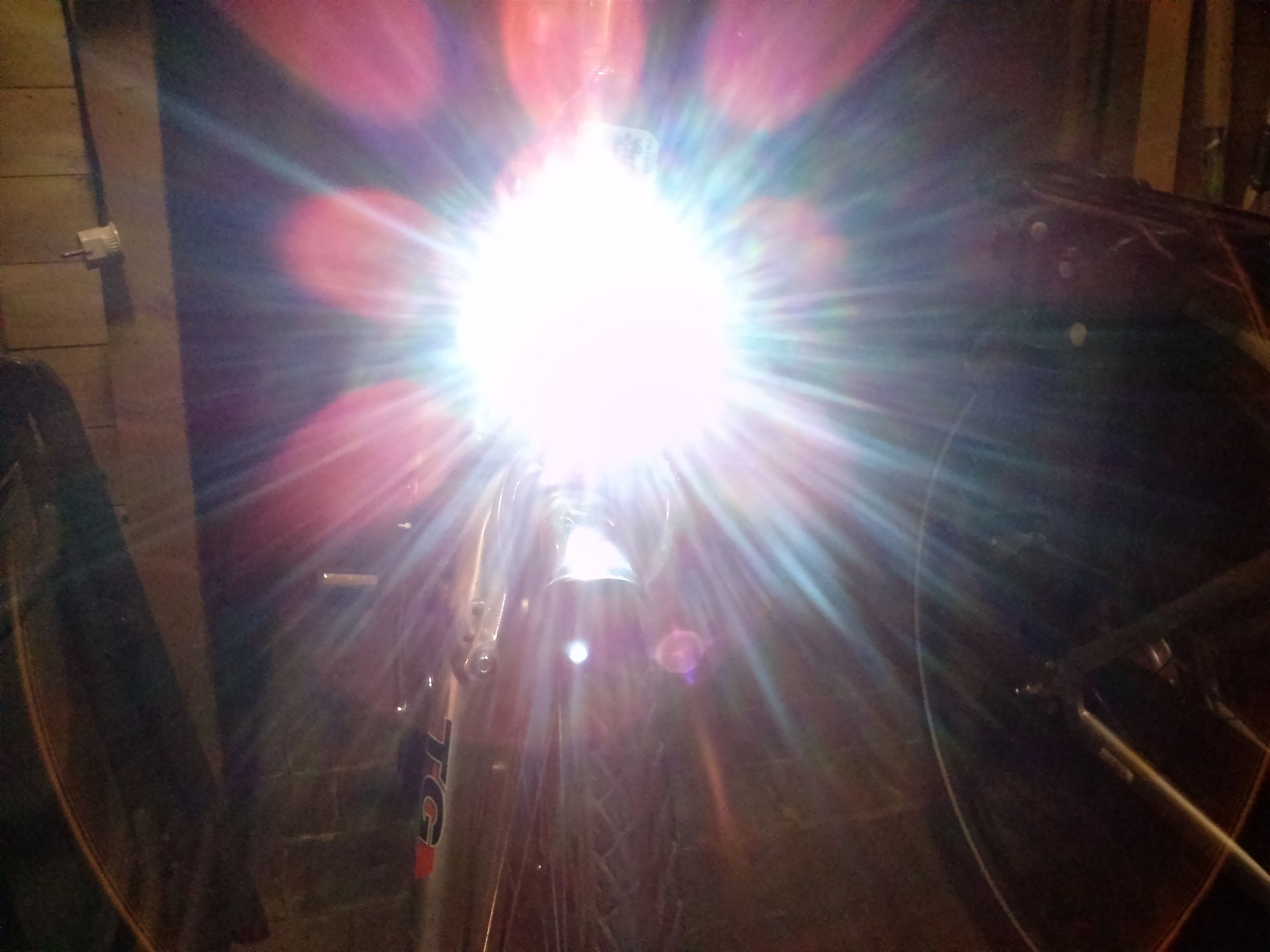

Step 5: Improvements / Review
Done!
Have fun with your portable floodlight!
  • I chose a warm colour temperature for the floodlight LED. Of course you can also choose a colder temperature if you like, the price for the floodlight is approximately the same.
  • Battery lifetime could be better. For me it is about 40 minutes. However, I only used cheap 18650 batteries, so the runtime could be longer for a higher capacity.
  • There is no real protection for deep discharge of the batteries by the step-up module. Therefore you need to rely on the protective PCB of the batteries.
  • Batteries do not get warm, however the case of the floodlight and the PCB slightly warms-up (about body temperature).
