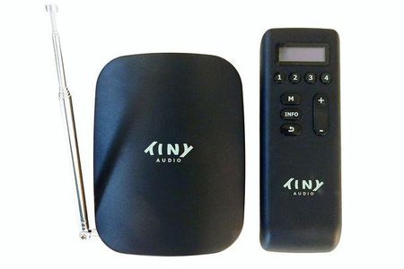

- DAB receiver with the ability to transfer the signal via FM. I am using Tiny Audio M8+.

You can extend the receiver FM antenna if like me you placed it away from the car radio.

The receiver comes with remote control and this is the gadget you will really need to control your DAB radio. The only display is on the remote so you know which station you are listening to.
I used a pop socket with a car mount to place the remote in a visible and usable location for me. But the great thing is that the radio can be controlled from anywhere in your car. So if your kids want to take control - you just need to give them the remote.
