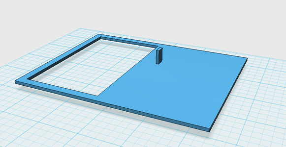

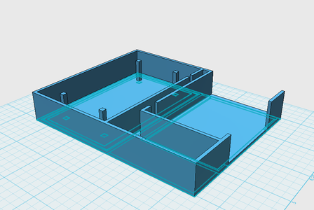

Step 4: 3D Print!
I got a hold of a 3D pi case on Thingaverse, printed it, and drilled a hole in the bottom of the case for the ribbon cable to come out of.
I then made an enclosure for the portable raspberry pi on Autodesk 123D Design, which is a free software.
The enclosure holds the wires and screen in place, while the pi in its case can slide in and out of the enclosure for access to the GPIO/SD Card.
Pi Case: http://www.thingiverse.com/thing:410003
Enclosure: http://www.thingiverse.com/thing:714844
Step 5: Hot Glue, Hot Glue, Hot Glue!
This may seem like overkill, but use plenty of hot glue to reinforce the build. Hot glue is your best friend.
I got glued the LCD in place, making sure the Red, Black, and White wires come out of the notch in the enclosure.
I also ran some superglue around the perimeter of the LCD casing.

Step 7: Glue on Bezel
This is the Final step for this project.
Start by laying everything in place (the pi) and lay down the Front plate. Hot glue the bottom-right in place and press down. Repeat this for the perimeter of the enclosure.
If you printed with ABS, you can paint on some acetone to smooth out the surface and fuse the surface together, creating a stronger and smoother job.
