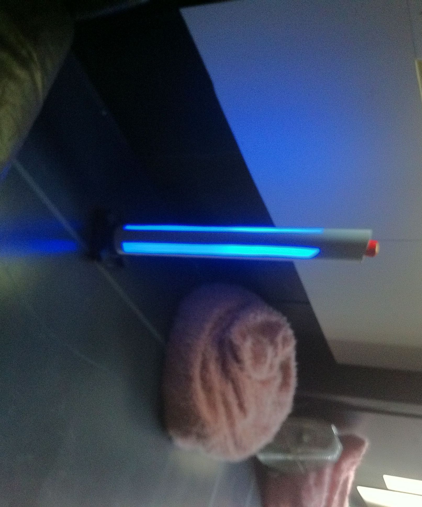

Step 8: Valve Man at Window - Vive Storage
I decided to get some black vinyl sticker material and cut the valve window figure. Stuck to outside of window and gives a good effect.
Also needed to make a storage box for the vive that I could access easily. Made from the left over MDF from when I cut out the door panels and some left over ply. Then painted with the Lexicon 1/2 and Night sky both Dulux colours.
Cut the Aperture logo out of the black vinyl using a template I printed out onto a piece of A4 paper. Just googled the logo and there are plenty to choose from.
I made sure the boxes the separate components the Vive came in fitted nicely in the storage box. The ply I made the box part from and ply for the lid. Got some cheap hinges to attach the lid and then drilled the box onto the 2 pieces of MDF (the left over cut pieces from the door) for the legs.
I still have to do the Button pedestal and the Lab testing sign have the material but have to find the time.
